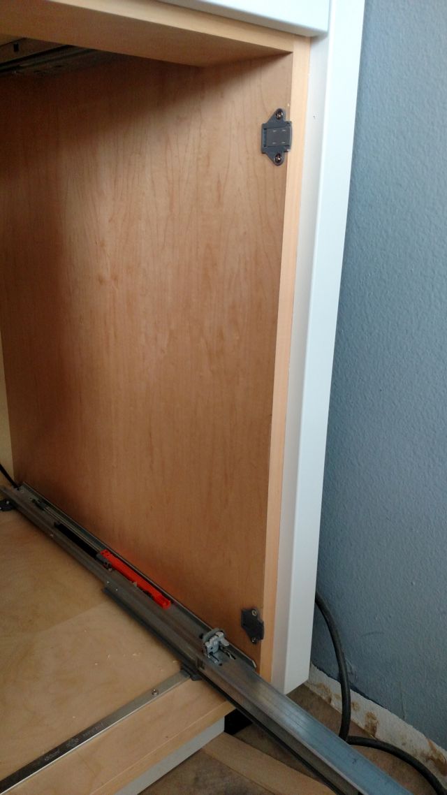

I've installed my first Blum servo trash slide out and it seems kind of finicky to operate?
I admittedly didn't understand where the second set of little spring cushions go and it seemed to work not as bad with only one set? Maybe that's my problem? Where should they be located?
Anyone have any experience or insight on this?

I locate my distance bumpers 2 5/16" down from the stretcher at the top and the same off the bottom . I also use the waste recycle set from Blum that comes with the tracks already connected and positions the Servo Drive exactly where it needs to be. I never have a problem .

I should clarify that I position them centered on 2 5/16 from the top and bottom on the left and right of the opening. If you measure from the bottom up to the center of the bumper it should be 2 5/16" etc...

Thanks for the detailed reply. That's not even close to what I did, so I'm anxious to try it. I'll be back at the jobsite later this week and will give it a go. Thanks again.

Thank you again for the set-up info. I moved the bumpers as you described and it works great! I really appreciate your help.
