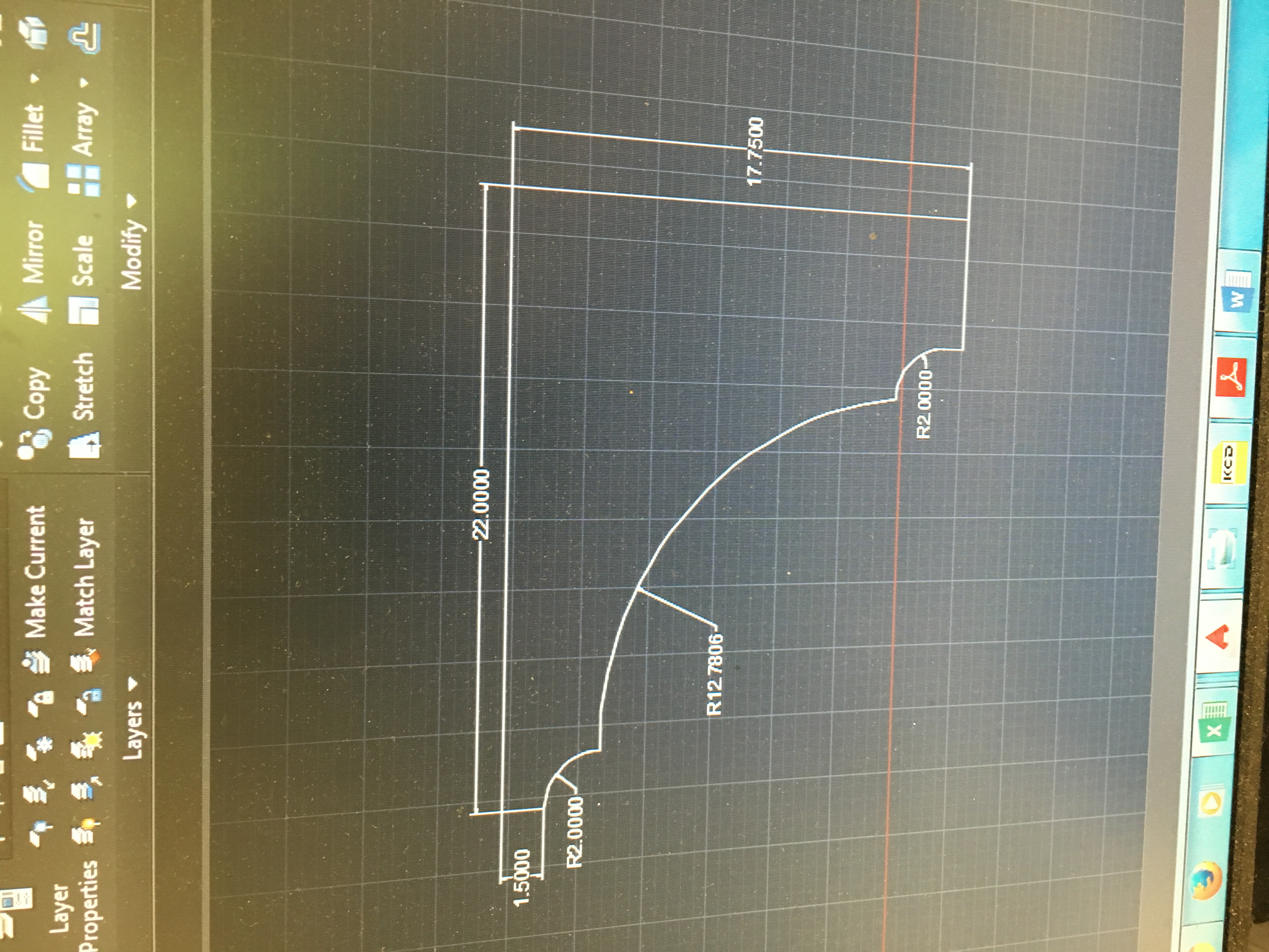

6/14/16       #7: source for large range hood corbels ...
james mcgrew Member
Website: http://mcgrewwoodwork.com
Easy enough, if painted use 1" mdf if stained use specific hardwood
We use two outside profiles and 4 inside profiles set back 1/4-1/2" then a cleat is installed at the back of the corbel, if you make a template you can use it over and over. if you have a cnc i can send the dxf
View higher quality, full size image (757 X 799)
