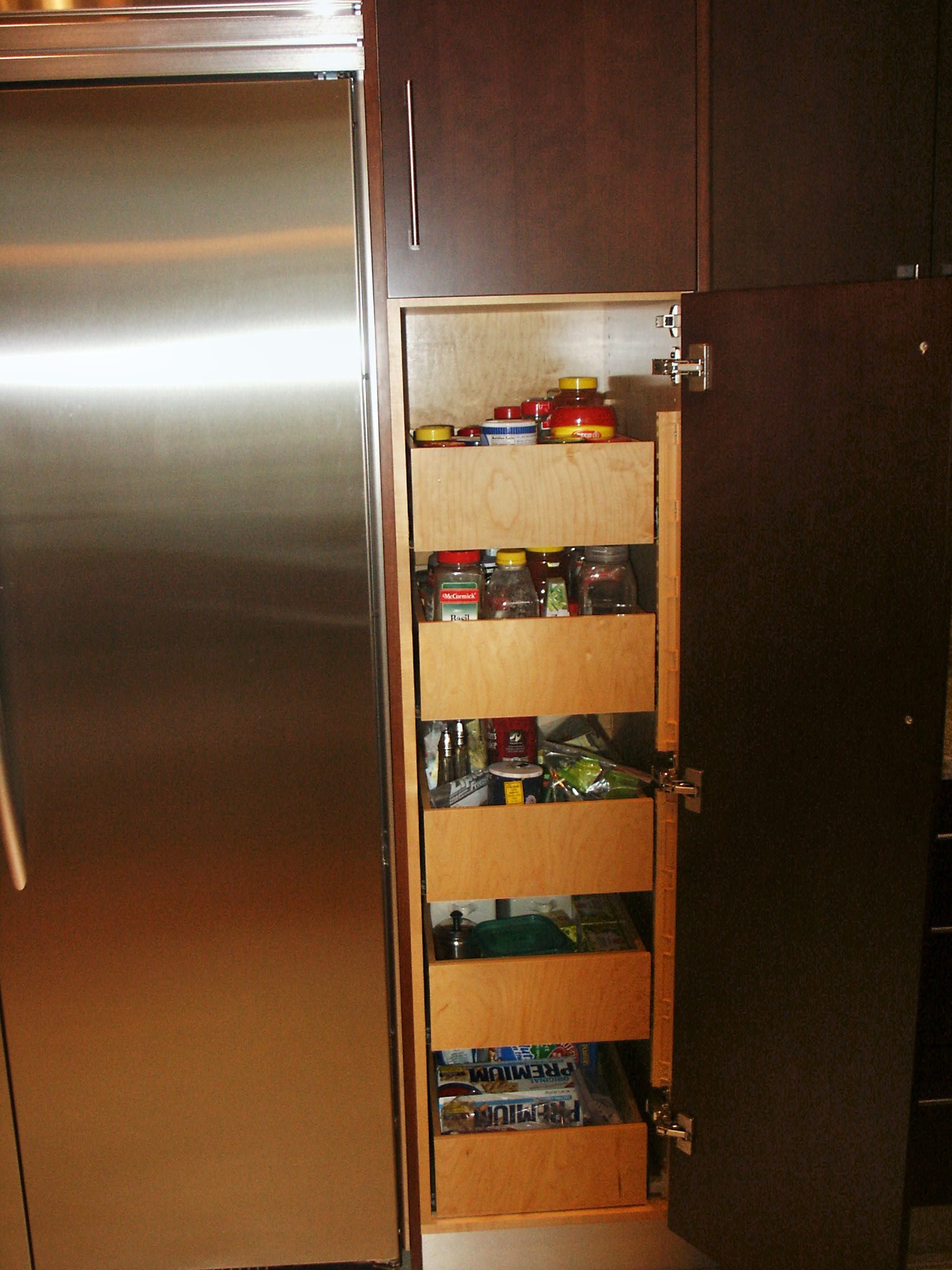

6/15/16       #6: Pantry Pull-out ...
Harold morantz
We have done them both ways. Depends on customers request. Most of our pantries are wider and we make internal drawers that are independent of the doors. We use Blum zero clearance 165degree hinges which crank the door out enough to not require spacers on sides. Makes for a stronger drawer as drawer slides are attached to cabinet, not with a 1" nylon spacer. We space them according to the clients needs. Canned goods, tall jars of olive oil or super big Costco cereal boxes.

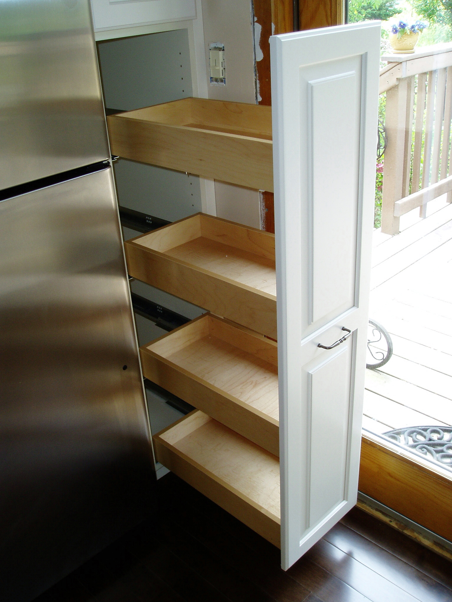

Adam Spees
In a highend inset beaded faceframe kitchen I took 6 or so dovetailed drawers and attached them all together with prefinished ply. Then one big paneled front. I used one of the heavy duty top/bot slides. Its never been adjusted in 10 yrs and maintains the 4mm gaps.
The slide was $250 + 6 drawers@$30
Looks just like Harolds
6/17/16       #11: Pantry Pull-out ...
Mark V.
Is this what Chipbored is suggesting?
The client liked this one so much, that 8 years later, he had me make another one.
