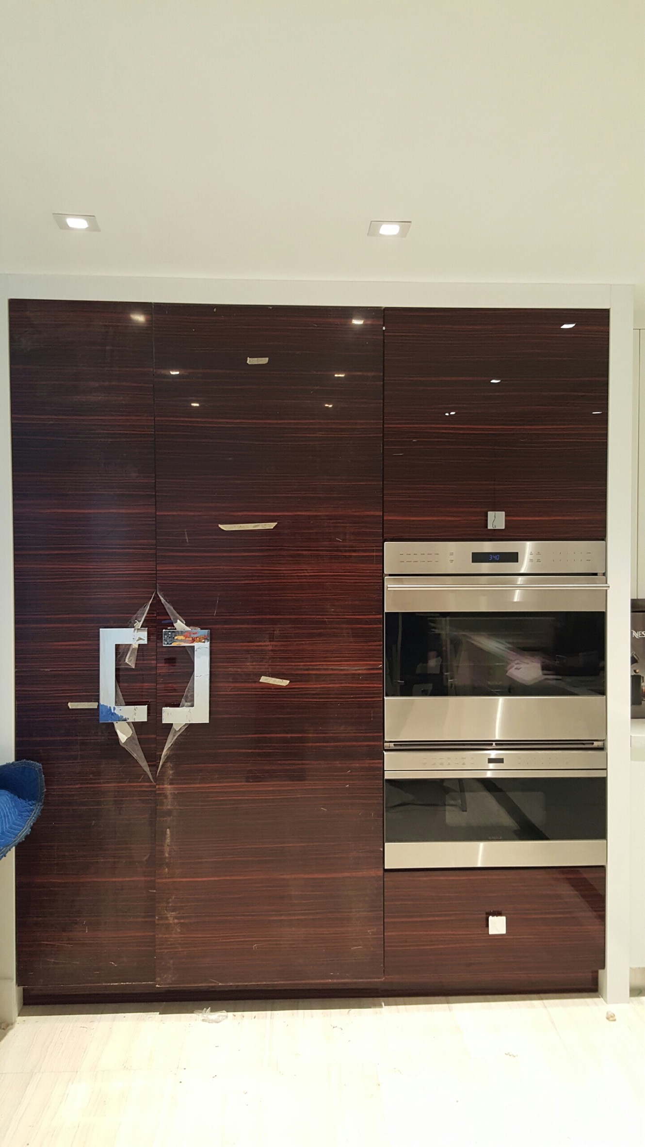

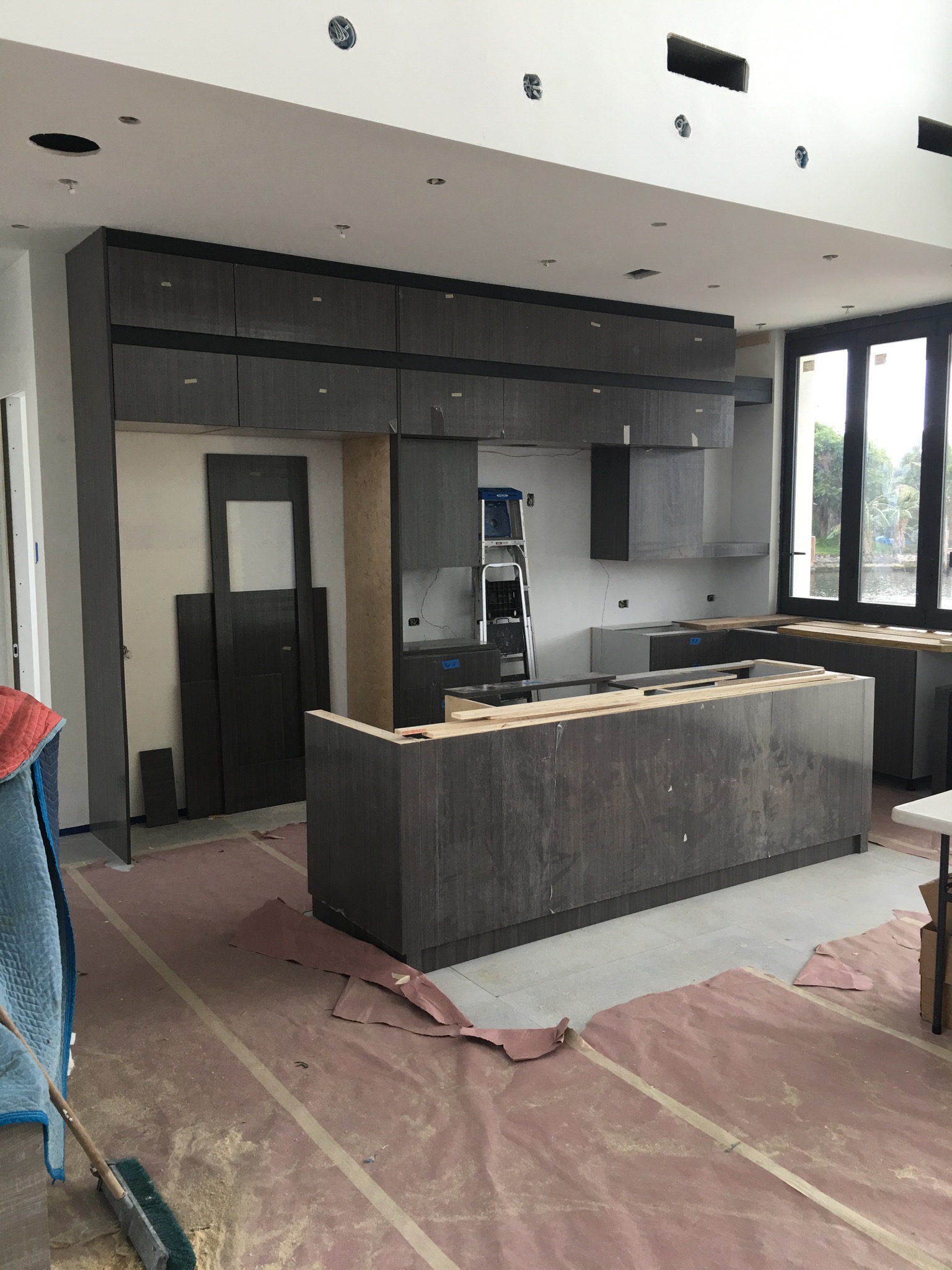

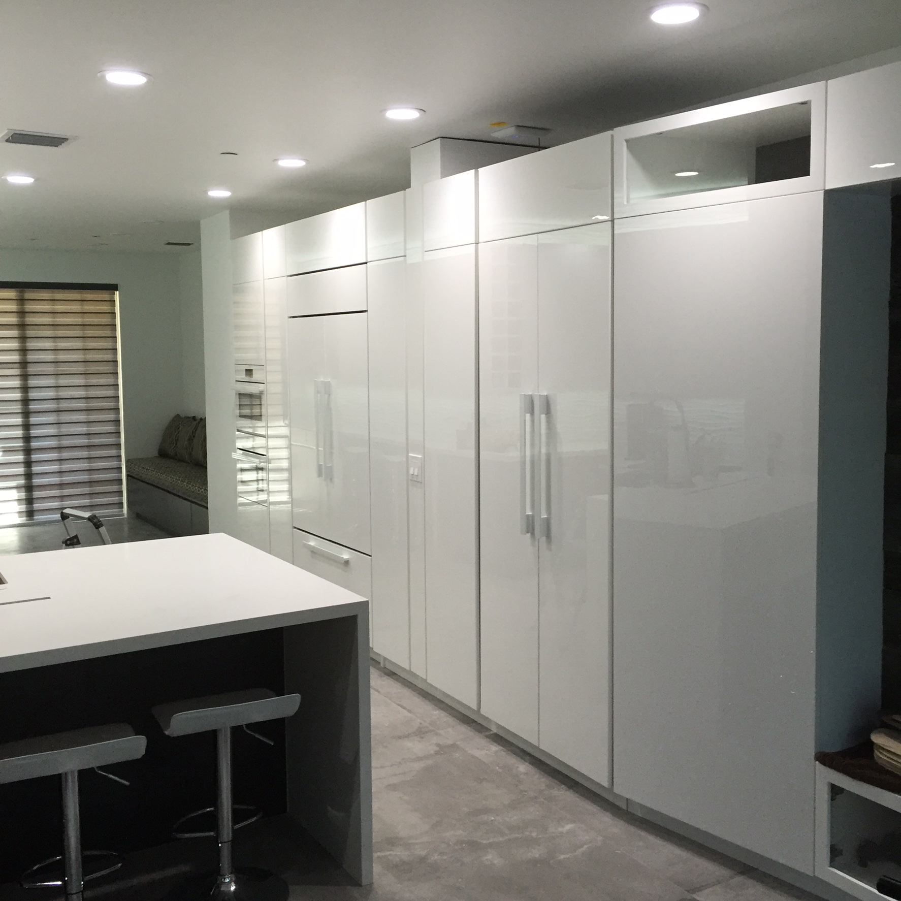

harold morantz
I have done this as well with thermador and subzero.
6/24/16       #4: thermador panel ...
Harold morantz
Here are some pics of a subzero fridge/freezer done that way and another kitchen with Thermidor wine fridge and subzero fridge with matching cabinets above.
View higher quality, full size image (1330 X 2365)
View higher quality, full size image (1774 X 1774)
