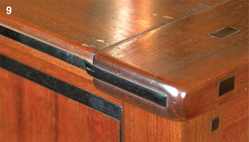

If you want to do breadboards on table tops, learn to hide/feature the movement with a spline and offsets the way Greene and Greene did on their work. They also used slightly offset pegs in slotted holes.

The Greene & Greens solution is elegant, hides slight offsets. I think David's photo is of the dining table @ the Gamble house in Pasadena. Go there if you are ever in CA.

The Greene brothers used screws to hold there bread board ends on and covered them with ebony plugs.
I have seen x-rays of there joinery and they used screws. Although there furniture was built by the Hall brothers.
The photo in Davids post is the Thorsen sideboard.

nicko - You are right about both the Thorsen Table and the screws. I had forgotten the the Halls did actually have to make this stuff, and make some money, so they used screws in many of their pieces.
Hiding or disguising the offset is the key.
