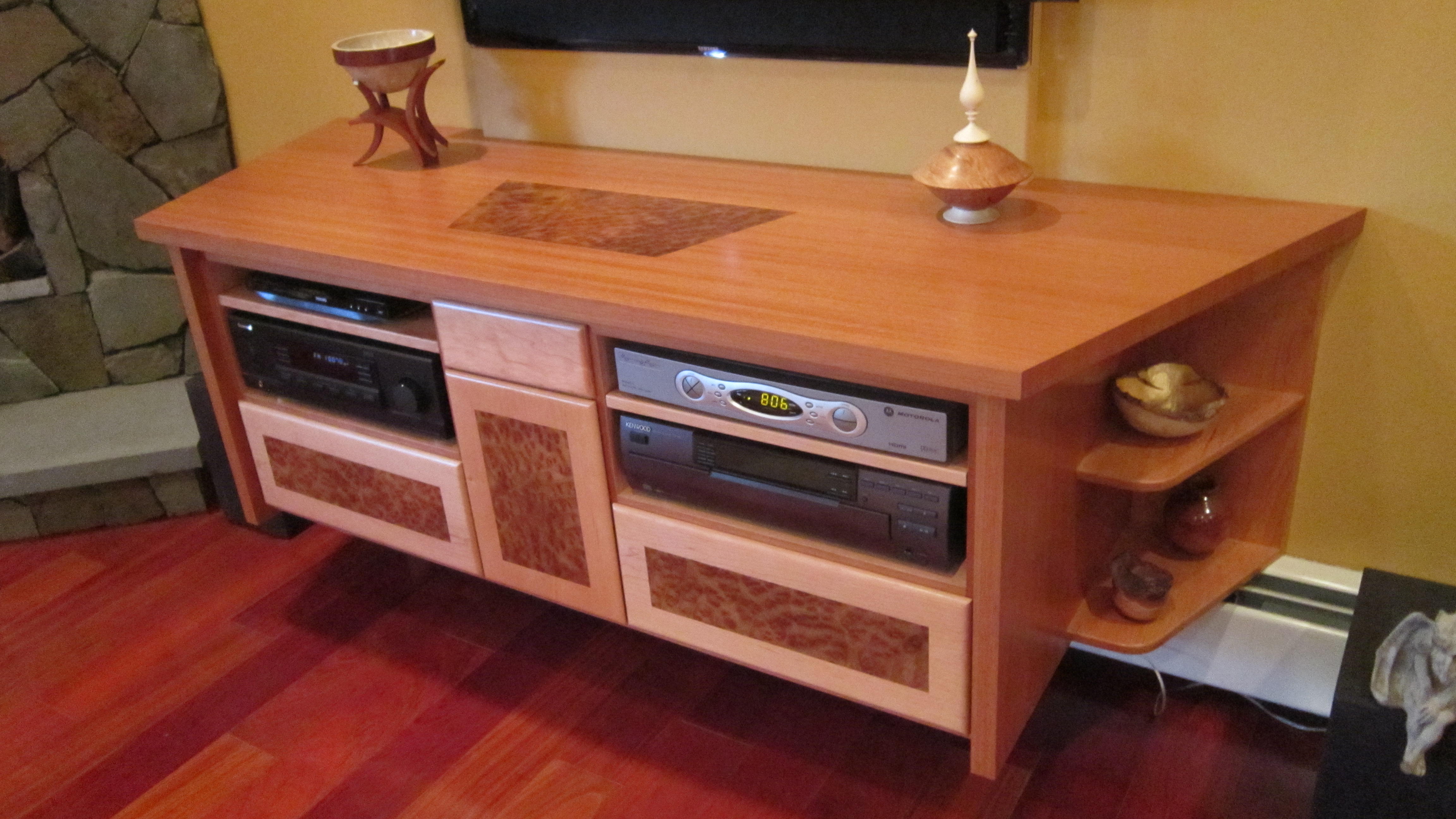

Good idea's but it seems that all the weight is dependent on the top connection to the rest of the cabinet. I did something a little different. I bolted an angle iron to the wall at the bottom so that all the weight rests on it and then i epoxy glued a heavy nailer to the top of the side walls and bolted that to a stud. I then attached the 2 side wings/shelf's a little lower to hide the iron. I know this may not work for your design as is, just throwing out another idea. Hope it helps.
