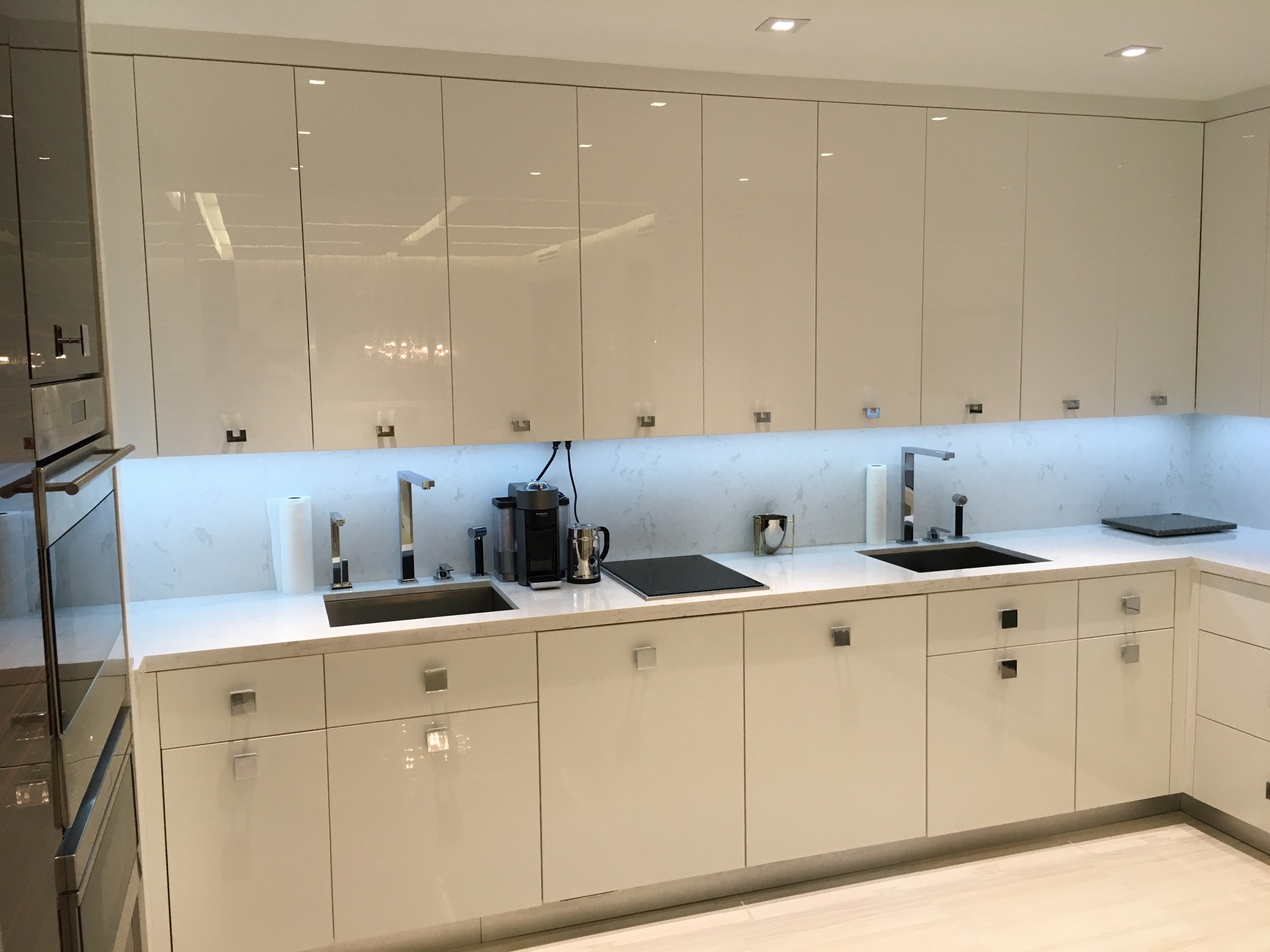

I need to make White high gloss doors.
Any suggestion what is best White edge-banding granulate glue to use ?

We do a lot of high gloss acrylic slab doors and any white or natural edge banding pellets do the job quite well with out
R Cheisa ep-9 Bander. Keep the glue line as thin as possible, keep rollers clean and adjusted and trimmers at a slight bevel with 1mm high gloss pic or abs banding and clean up edges with some mineral spirits and the doors will come out great. It's not an invisible line, but to achieve that you will need the newest banders with no glue line technology, which is beyond the price of most small to medium shops today.
