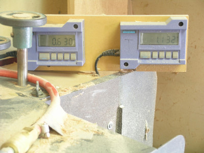

Wixey side view on my Jet planer
View larger image
7/21/16       #11: Planer Digital Read Out ...
Leo G
Front view
View larger image
