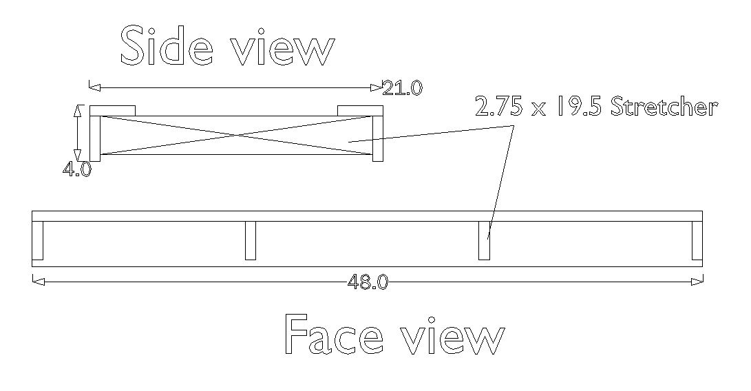

We use loose toe kicks (ladder method). Used to use leg levelers but they were expensive and my guys had a hard time making finished ends look clean. The ladders get easily nested into our sheets and almost never require more than one extra sheet. I have CV set up to cut back toes and sleepers out of the cheaper material in the schedule and only use the good stuff for toe faces and side toes.

We cut the length of the ladder to what is needed and 3.25" wide. the stretcher is .5 up from bottom this allows with some scribe up and down to be as much as 1" if some shimming is required.

I'm sure you have reasons for doing this the you do.
If you are going to scribe the toe kicks I would add a loose face so that the installer only has to scribe the face. Then screw from behind.

8/9/16       #22: Toekick Construction Methods ...
Which begs the question why bother with the extra material and labor in your detail?

One method I've seen is to take the ladder toe kicks and shim them to the level and the desired height. Then take some 4" x 4" cutoffs of the same plywood, and screw them to the inside of the ladder frame, tight to the floor...then pull out your shims, and move on.

Me too, it is well worth the time to do it this way.
Good Point.

james mcgrew Member
After shimming We do what Gary does
