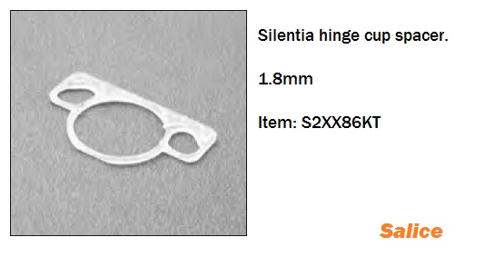

Hoping Dennis will chime in on this one. I'm in process of starting a kitchen which
has laminate doors with aluminum t molding. The edging wraps around and protrudes 1/16" above front face and same on back face. I plan on using 105 degree soft close hinges. Hinge arm hits edging as inserted right now. I'm looking
for pre made shims to raise cup so arm clears edging. Tried washers under hinge but they don't keep hinge flat and true.

Al,
This spacer will lift the hinge cup up 1.8mm. Any Salice distributor should have these in stock. (Item: S2XX86KT)
What is the overall thickness of the door including the 1/16" protrusion of the aluminum front and back?

al
13/16"
8/11/16       #4: Salice spacers for hinge holdout ...
You should be good.

al
Dennis,
Do you slip these spacers over the dowels and proceed with the insertion machine?
