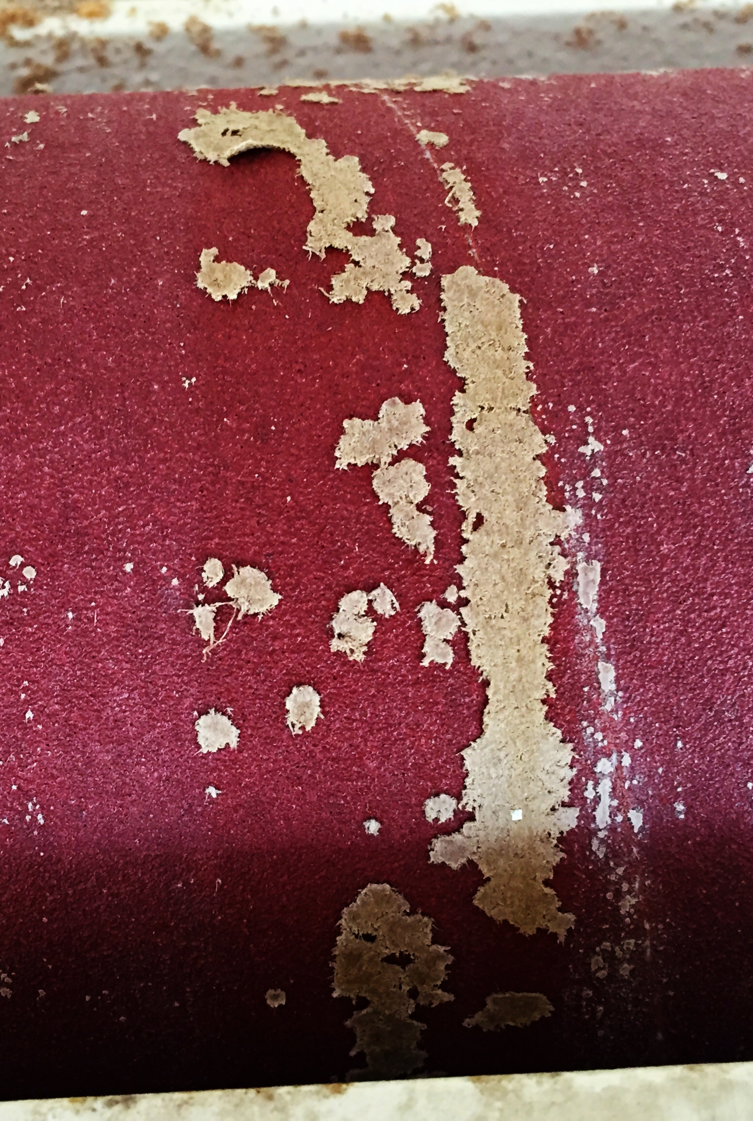

I have some 3/4" walnut on mdf core that im trying to "plane/sand" down to 5/16" and it keeps gumming up on me. I tried using the "eraser" of you will, but to no avail
Im using P80 grit CS311 Klingspor J-Flex
Wtf am i doing wrong?

I can't tell you what's wrong, but with the patience to use an open sander to go from 3/4 to 5/16 you missed your calling as a monk :)

Can't say I've ever tried it but I'd think you'd need far courser abrasive than 80 for mdf on a drum sander. Too much heat and super fine dust with 80.

I have the same machine. Switch to 40 grit and speed up the feed rate. The dust is getting built-up too quick using 80 grit.
