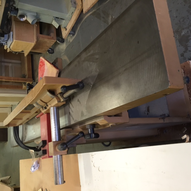

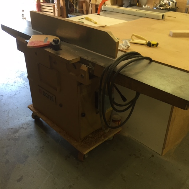

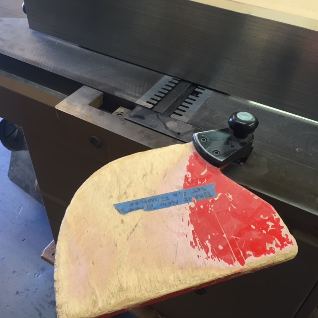

This is a 12" SCMI jointer. ~83" long w/ a 4 knife cutter straight knife head (I'll would get a byrd spiral aftermarket if I buy this) I have a 2 man shop and turn out custom cabs and some furniture. Been thinking of getting a grizzly, but Ive heard too many conflicting stories. Thanks for any input

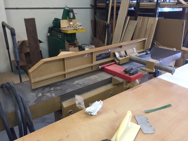

more pics

Don't know what the going rate is for a 12" machine these days, but that machine used is worth as much as a new Grizzly to me. Never cared much for their machinery. In general, (as long as it checks out on inspection), you can't go wrong with the heavy SCM stuff.
good luck,
JeffD
8/24/16       #4: how much would you pay? ...
After a good inspection with a quality straight edge, and it checked out, I'd pay up to $1000.

Just curious why you think you would need to swap out the cutterhead? I know a lot of the hobby guys love those spiral heads, but I had one on a planer and can't say it was worth the money. Personally I would buy the machine and use it.

Check the bearings. We had an old SCMI back in the 90's that ate them by the year.
Also check the straightness of the fence & table. Sometimes the old iron will settle with a little twist.
Slop in the dovetails. Jointers can be fussy bastards to get dialed in when they get a bit worn.
