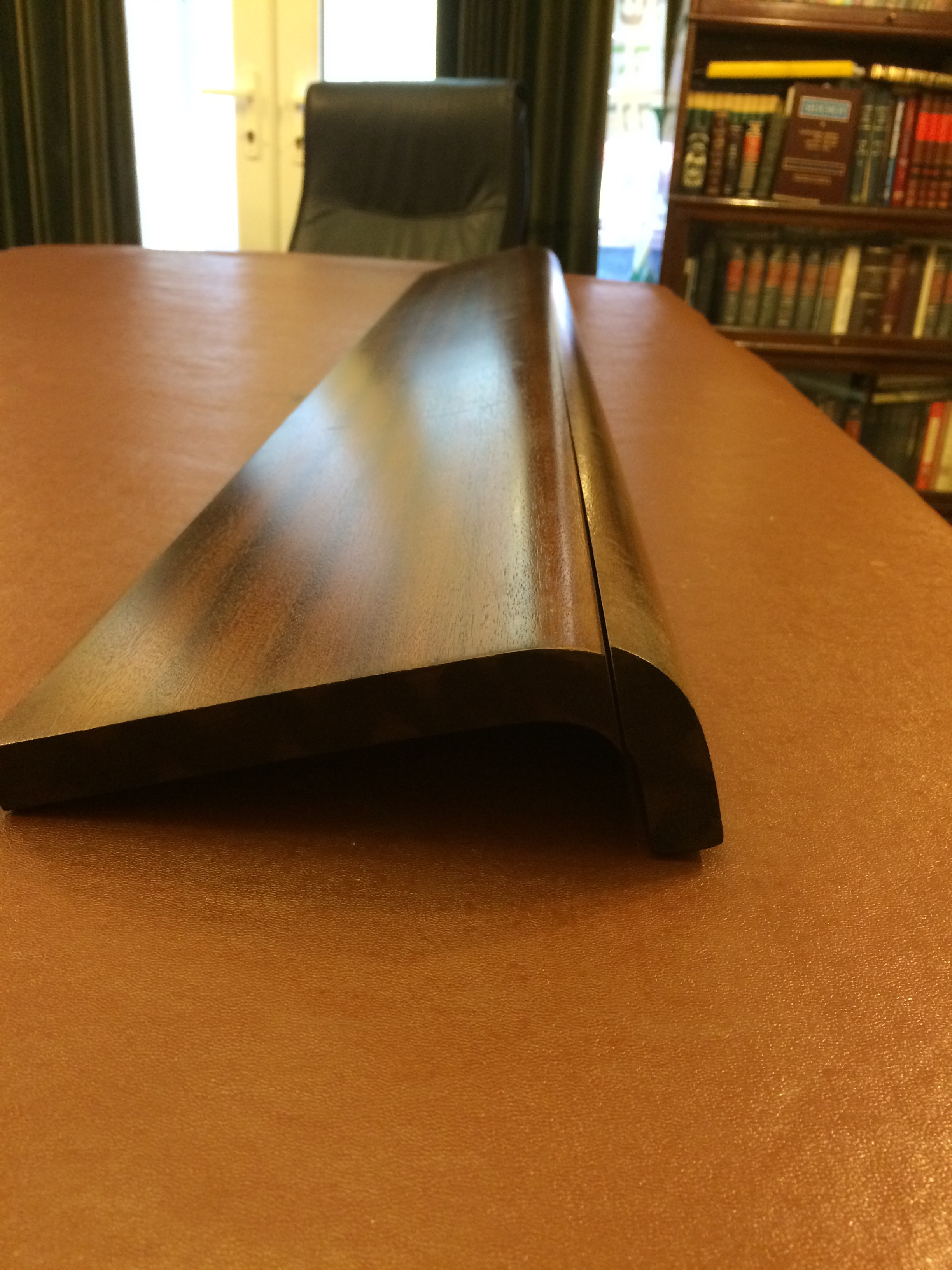

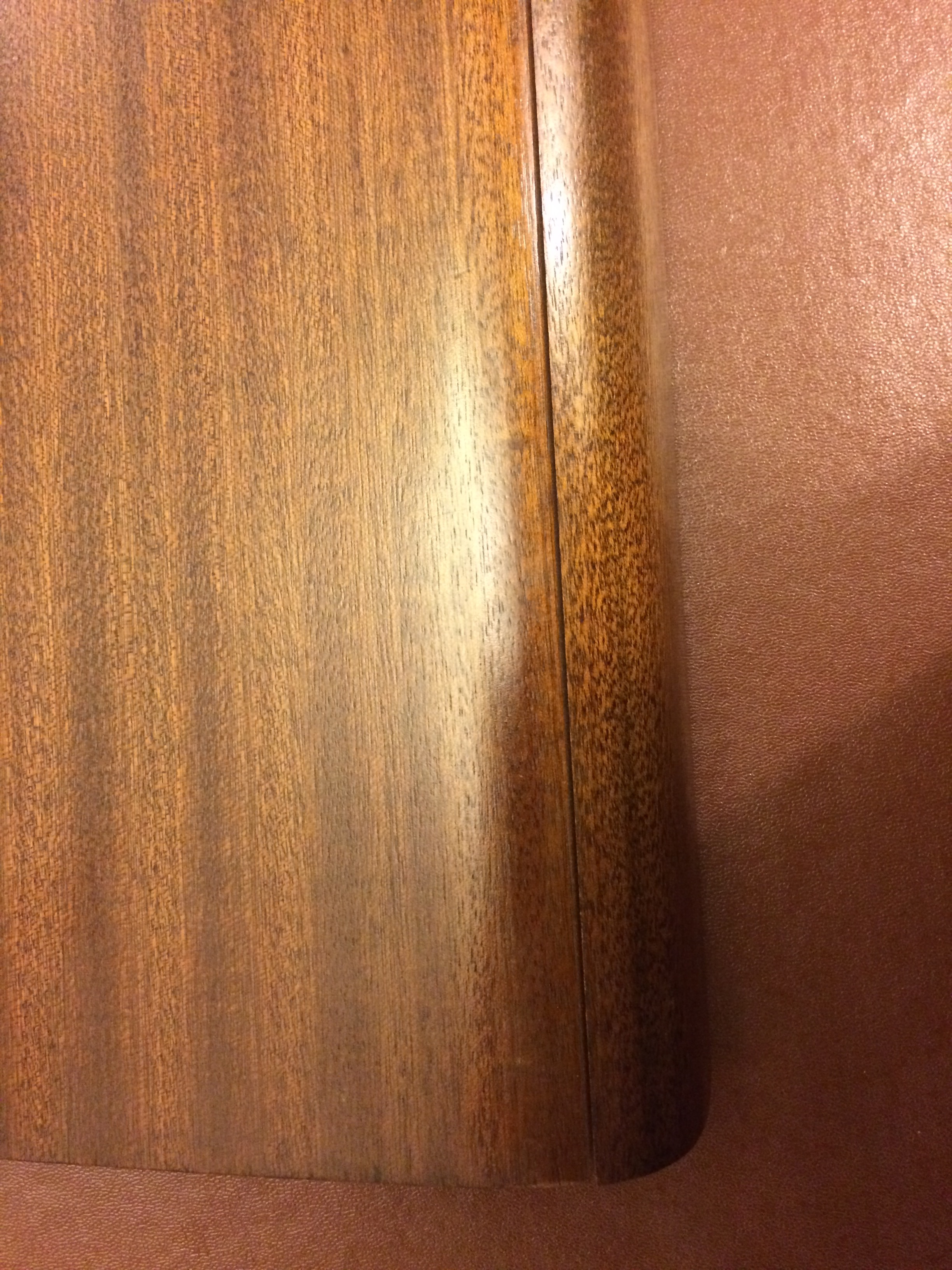

I have been asked to repair the fall from a 1950's upright piano. The fall is a piece of mahogany covering the piano keys, which appears to have been made from one piece, then sculpted out as required, then finished in satin polish. Over time with dry air and sun bleaching, the wood has warped, with the curved lip parting company with the main body of the fall on the left hand side when viewed in closed position from above. One can hold the two parts of the split together by hand, but it is difficult to clamp because of the shape and the finish. Please see the uploaded pictures. Can anyone suggest a repair method, and what glue would you use please?

It looks more like a glue line failure than a split and doesn't look warped judging by the pictures and looks a lot like Sapele.
I would look very carefully at the old glue residue to see if it will interfere with the new glue then make plywood clamping blocks the exact shape needed to apply pressure were needed. You will go through a few prototypes but in the end you should be able to dry clamp it back together and close the joint completely. If not give it back to them wishing them the best of luck and not do a bad job. A bad job stings more than admitting you can't do it. Remove wood on the clamping blocks directly over the joint so you don't glue the blocks to the project.
I would use epoxy (west system) I've been using it for years and have complete confidence in it but also i know the thickness of it (thin) and the work time is as long as you need. Once on the wood you can spend 20 minutes easily fiddling around with it. Carefully wiping up the squeeze out and let cure till the next day. You will feel the joint and it should be sanded and refinished but if it is close enough show it to the customer and let them decide but i would definitely inform them of it needing to be refinished before taking the job. This is just my 2 cents if i had the job I'm sure others will have something completely different. Good luck.

First, clean off any old glue residue. Be a bit rough with it, and it may come apart the rest of the way. I doubt it was sculpted from solid, most likely two pieces joined with hide glue that has aged out.
Run good quality masking tape on both edges of the joint as close to the edge as possible, both inside and outside on the parts. This will make clean up easier. Then, I would use the same tape to clamp it closed. You can pull it across the joint and get plenty of pressure. Use yellow glue on clean wood. Epoxy likes to be a thick glue line so it will show. Clamp epoxy tight and the joint may starve.
Do a dry run with the tape so you what to expect and get the joint leveled as you go. With luck, you may avoide finish fussing.

On hard to clamp projects like this, I cut little fixtures out of scrap ply that have slots cut out allowing them to slide over the back edge of both sides. Then I cut a notch in the top of each leaving a tab for the clamp to grab onto. This way you can use hand screw clamps to apply as much pressure as you want perpendicular to the break, and have total access to the glue line for cleanup with a damp rag.
If this isn't clear, I'll do a sketch and email it to you, but short on time now.
