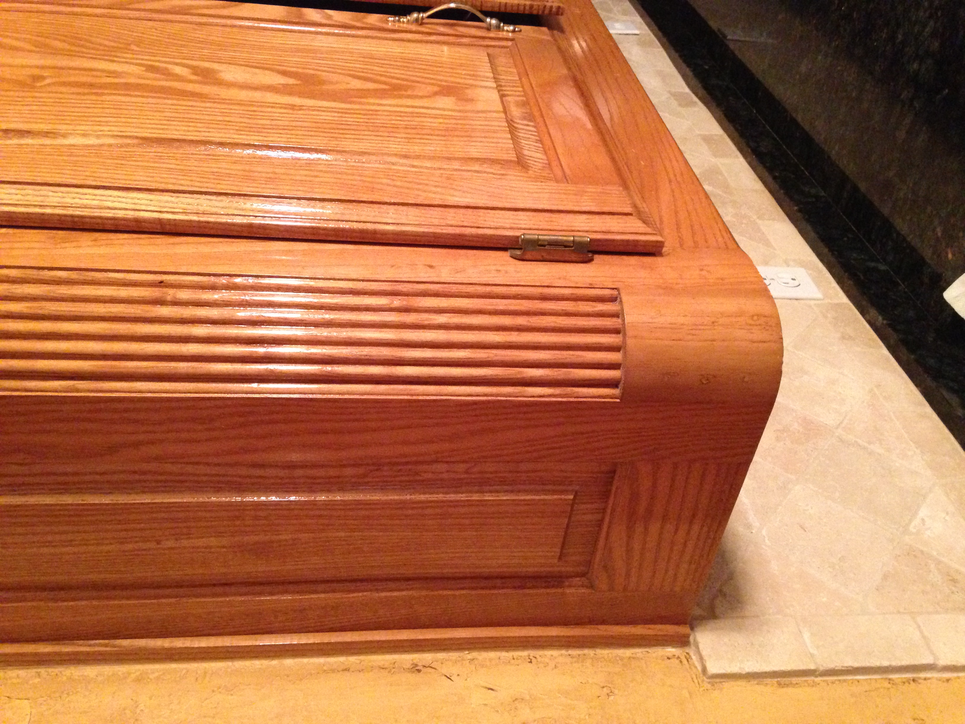

Hello
i have several cabinets installed in kitchen which have a turned/fluted? semi-circular insert on exposed corners -- which someone told me can be taken out and replaced.
Is that true and if so, how would they best be dislodged and where would one source replacements?

Dave L
No insert there. The corner is an integral part of the face and side of the cabinet... Why all that work and not leave enough to scribe it to the wall (sans scribe mold).

Perry Vavra Member
The beaded corner is a piece of moulding set in between whatever is at the top and the bottom piece of universal moulding. If you can look inside the cabinet, you'll be able to see what is going on. If it is glued then be very careful not to tear out cabinet styles. You should be able to take a 3/4 inch block and tap it out from the inside to remove it. Very common moulding in the Dallas Ft. Worth area.

Gary
Perry is right on. Looks to be easy enough to remove and replace assuming you do this in your shop and not onsite. The potential problem I see is that it appears to possibly be ash not oak which may limit your options for replacement unless you make them in house. Maybe they are oak?

mike merchant
Thanks Perry - you got me, I'm in DFW. Since you are familiar with these, is there a source to find alternatives or do they have to be made?

mike merchant
Thanks Gary.
The owner wants to paint them so matching may become a manageable issue if the cost/effort of doing it to begin with makes sense - which is why I asked Perry if there were ready made alternatives.

Perry Vavra Member
Try Brazos Forest Products, 2760 N Great SW Pkwy
Grand Prairie, TX 75050
