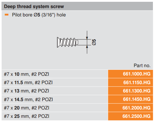

If you are cutting w/ CNC and prepping for slide fixing, which screw length is preferred, and what hole depth is cut?
Talking about 19mm melamine PB.
View higher quality, full size image (521 X 409)

If you're making single boxes then go for the deeper screw. If you're doing custom boxes that have shared partitions go with 11.5mm

We use the 13mm with a .5" deep hole in the panel. When we have a single thickness divider between drawers on a double drawer unit, such as a 36" wide cabinet, we use a 5mm length screw. If you use anything longer than the 11.5 you risk the screws butting into each other. We always bore all holes the same depth.
