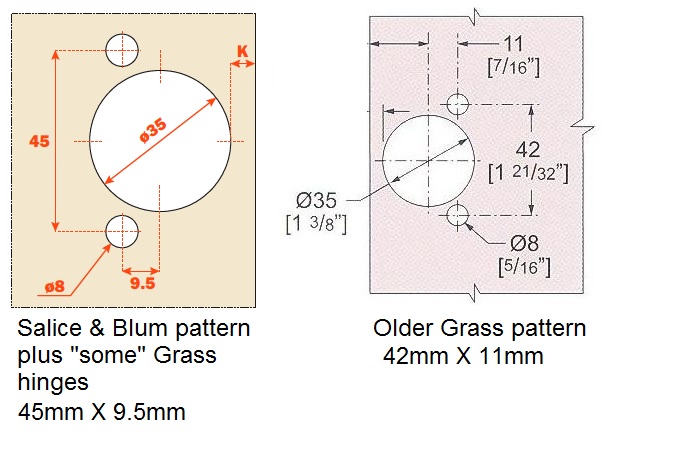

This looks to be a newer machine. I would be having it shipped to me. How should I tell the owner to measure it so I know it's compatible? Thanks.
11/28/16       #4: Is Grass hinge hole pattern compati ...
This is how the boring pattern is measured. The current owner probably knows the answer to your question but, if not, the surest way to check would be to drill a set of holes and measure them or...drill the holes and hold a Salice or Blum hinge up to them to see if they match.
