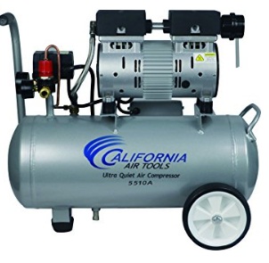

Mr Waker Member
Tank size is one of the main and first factor before choosing an air compressor for any purposes. Personally, I have the California Air Tools 5510SE ultra quiet 5.5 gallon air compressor. Its motor produces 120 psi max of pressure and delever 3.10 CFM at 40 psi & 2.20 CFM at 90 psi of compressed air.
Best quiet air compressor

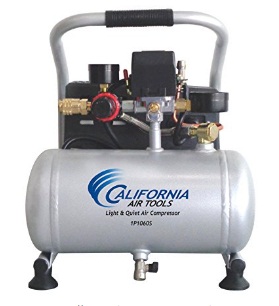

5/1/18       #30: Compressor tank size vs cfm ...
Mr Waker Member
