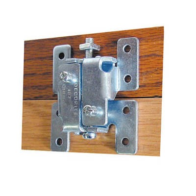

Mdf core with whatever veneer.
Connect with draw bolts or these (see pic)
