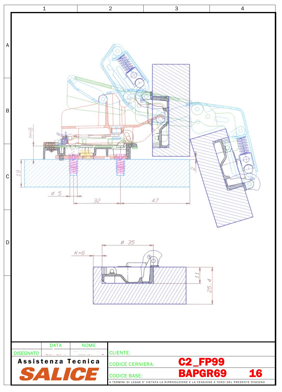

Looking for a Salice hinge with 150 to 180 Deg. opening capability for a Inset Application, door is 1" thick and reveals around the Door is 3/32". My face frame and inside of the cabinet is flush so I guess 0mm plates, thanks for any help

Hello Eddie,
For this application I would recommend the Salice 165 degree hinge for inset with a 6mm mounting plate. To achieve the 3/32 gap, use a 5mm edge bore distance (TAB).
Salice Part Numbers:
C2RFP99 – 165 degree hinge, inset, self close with dowels
BAR3R69 – 6mm mounting plate, cross shaped, clip-on, for wood screw installation.
Here is a drawing detailing this application. Please note, the mounting plate shown in the drawing is an in-line straight plate, 6mm thick. Any 6mm plate will do the job for you here.
Below is a link to the Salice web site for this item with additional details.
