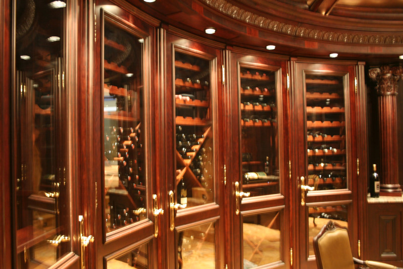

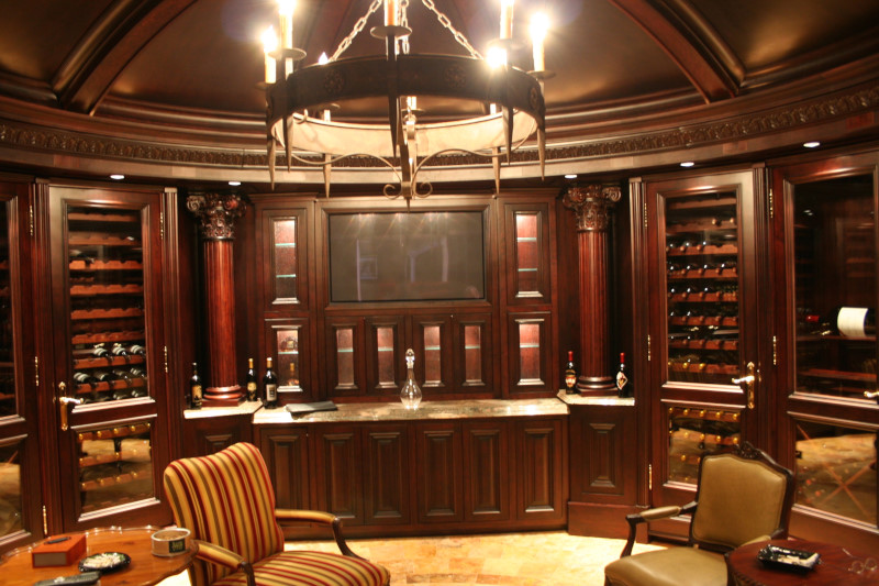

We built a 30' diameter wine room 14 years ago that had refrigerated cabinets and even a humidor all built in. The refrigeration was and HVAC was all done by a regular HVAC contractor. All Cherry solids and veneered hardwood plywood. Conversion Varnish, as I recall.
I just had occasion to go back and visit the room due to a roof leak that damaged some of the woodwork (the leak is not related to the room, but the patio above). Basically, the room looked fine, no buckled veneer, no warp, no nightmares, large or small. I did spot a few small areas of mold growing and pointed this out to the staff. The mold tells me that the fans are not adequate to move the cool air (55 degrees) thru the cabinets. Each cabinet is open to its neighbor, with compression gaskets on all the doors and 3 point latching.

Thanks for the responses James and David. I've discussed this with the client, and I think we're going to skip the humidification. We also may clad the the interior with stainless steel sheet metal.
Fantastic work on that wine room David!
