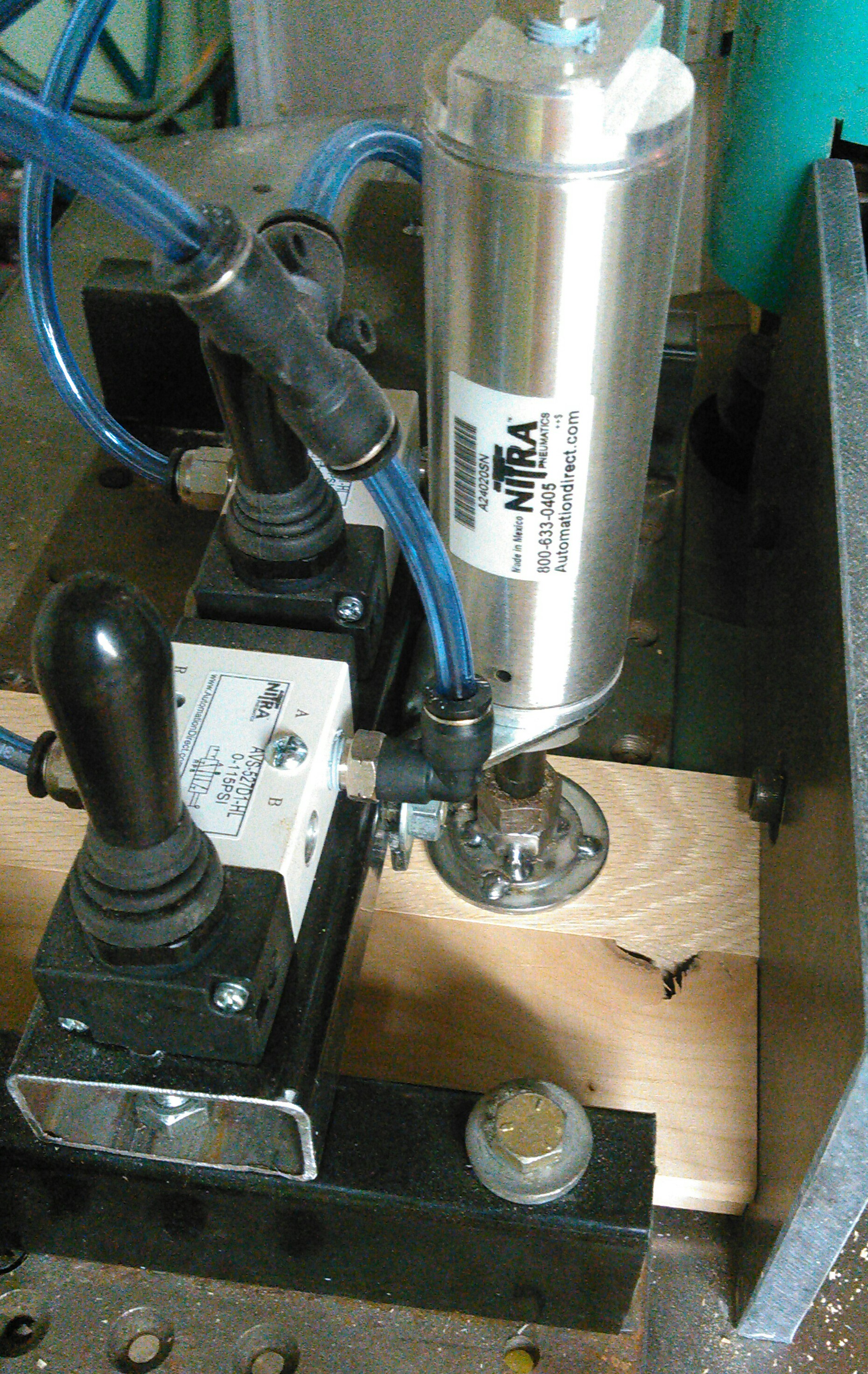

Looking for a shaper fence system for running stile. I have a three headed woodtek shaper and the stock fence was terrible so I made my own. Anyone else make a nice one or know of a high-end system? Right now we have a large power feed on it. I have seen Weaver makes a belt to go around the wheels. Anyone have a power feed that's belt driven instead of wheels?

I made this fence system last week for cutting tenon's. Working on making the stile fence now.
View higher quality, full size image (1860 X 2944)

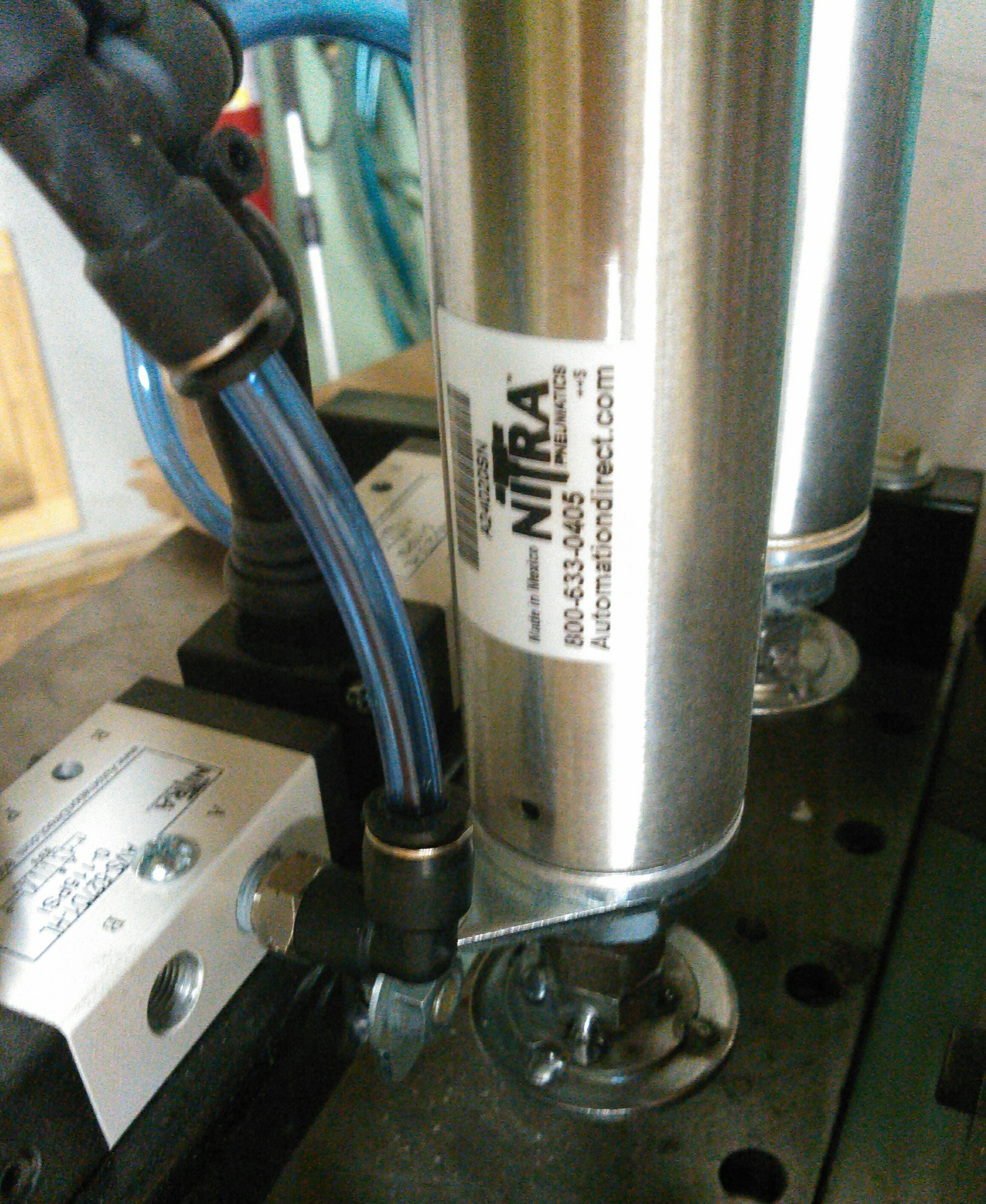

More pictures
View higher quality, full size image (2314 X 2826)
