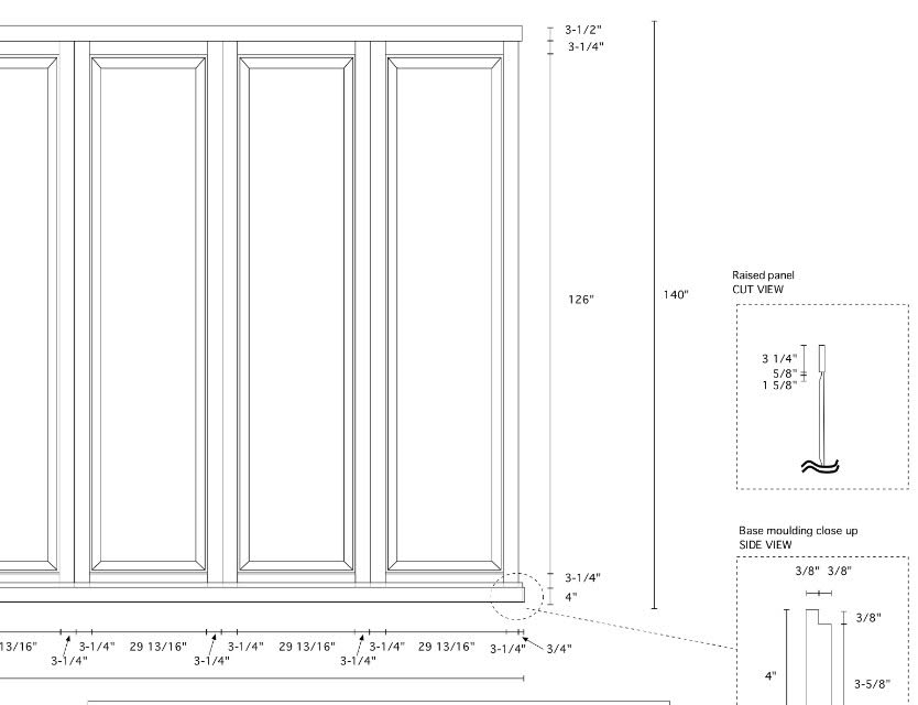

I have to make 12 feet high raised panels and am worried about wood movement and installaion method.
Nine panels will be installed against a wall, side by side.
The wall is a U shape and so there will be a one-panel return on each ends.
Stiles/rails: Width 3-1/4" and 1-3/4" thickness
Raised panels: Width 30" and 1" thickness
I intend to make the entire panels entirely out of solid african mahogany as I work faster with solid than veneer work. I will ensure the center raised panels are free floating (I'm thinking of 3/4" groves all around).
WOOD MOVEMENT ISSUE
I'm worried about stiles and the center raised panels from warping.
Is there anything I should be doing to prevent the panels from warping?
INSTALL ISSUE
These panels will be pretty heavy. While I won't be installing them (GC is), I would like some tips on how to fabricate the back to allow smooth installation and safe attachment.
Feedback from experienced woodworkers are much appreciated.
Thank you as always for providing your advice!

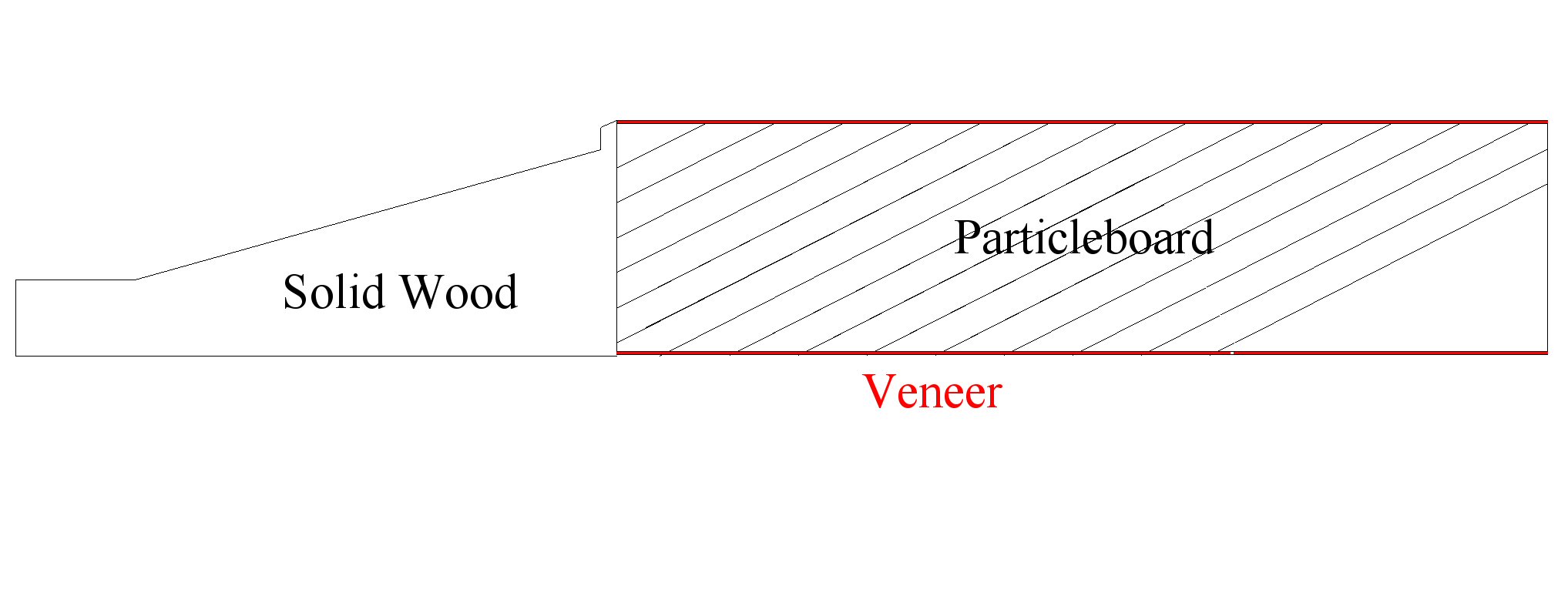

3/22/17       #26: Tall oversized raised panels ...
Leo G
Personally I would have used a veneered particleboard for the main area of the panel and wrapped that with the same species with the wrap being about a 1/16" oversized so the panel cutter wouldn't reach the particleboard core.
Do a slight bevel by hand after it's milled and it would hardly be noticed. That way it would be something you could do in house and it would be more than stable. It would have veneer on both sides already.

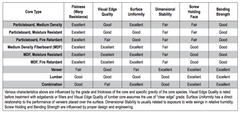

3/22/17       #28: Tall oversized raised panels ...
Marsay Member
Hi Leo, thank you for your input. I checked out the AWI standards, and they do include particle boards like you suggest. I will discuss this option too with our local fabricator.
View higher quality, full size image (960 X 455)
3/22/17       #29: Tall oversized raised panels ...

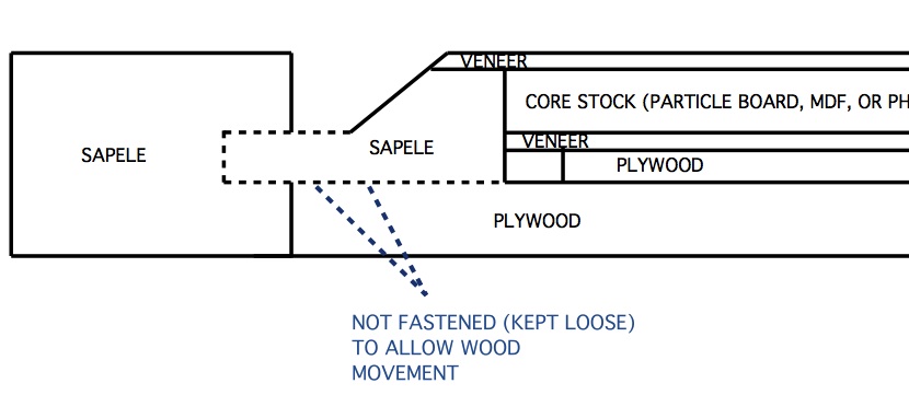

Marsay Member
This is how I imagine the panels would be made.
View higher quality, full size image (830 X 361)
3/22/17       #30: Tall oversized raised panels ...
Leo G
My thoughts of how it would be put together.
View higher quality, full size image (2035 X 800)
3/22/17       #31: Tall oversized raised panels ...
Marsay Member

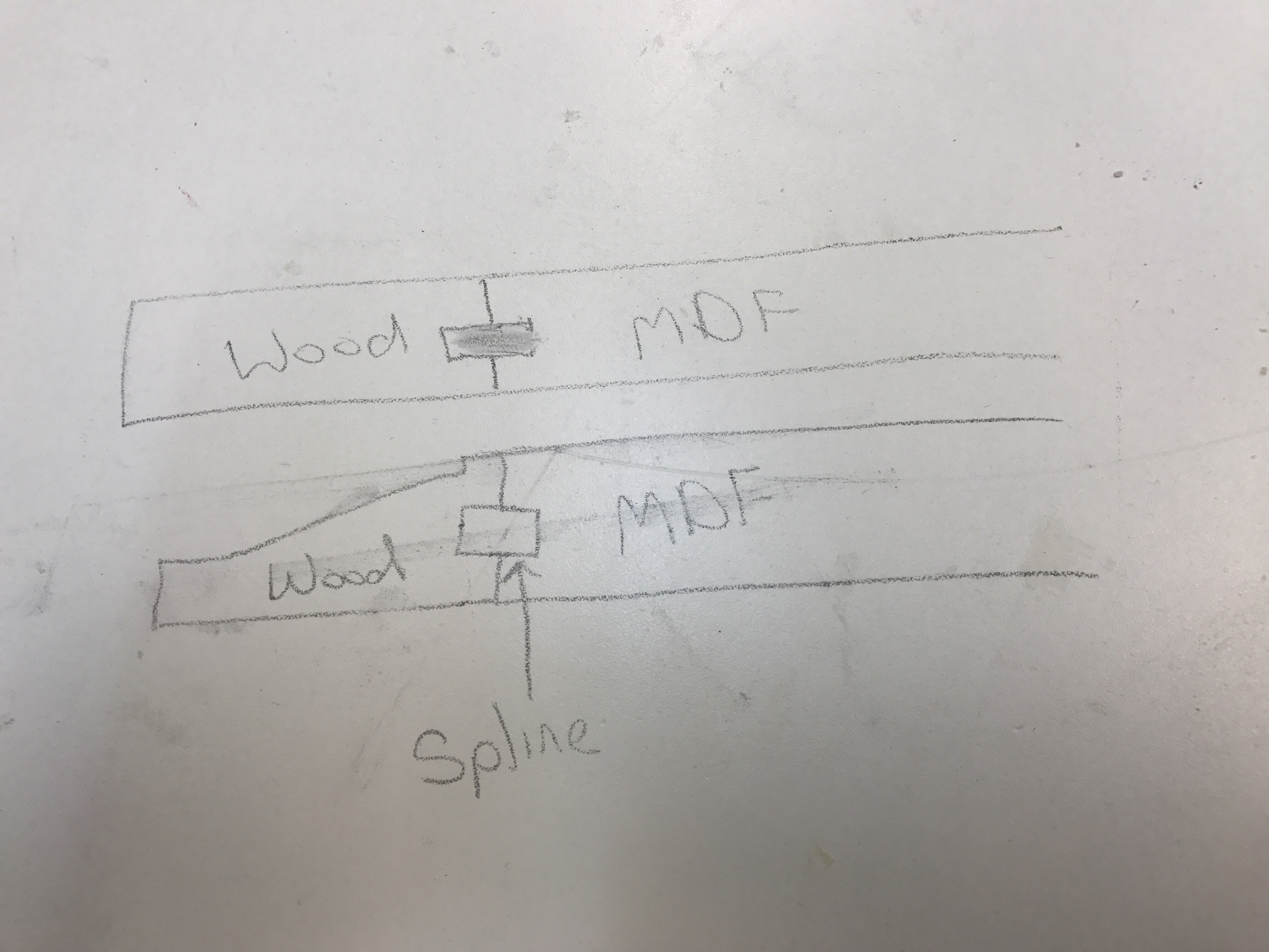

Hi Leo, thanks for the image. Yes, I was initially thinking of making them exactly that way.
But then I was thinking of how to minimize the core-stock/solid wood seam.
3/23/17       #32: Tall oversized raised panels ...
Matt Calnen
I make mine by adding the wood first to the core material. Trim or sand it flush then venner both sides. Then raise the panel profile so the venner to wood joint is hardly noticeable. I would recommend unibond for large panels over venner pva glues. To much water to add to a large area.
3/23/17       #33: Tall oversized raised panels ...
Matt Calnen
3/24/17       #34: Tall oversized raised panels ...
I would have somebody lay it up mdf or particleboard. Whatever that shop likes to use . Mill up the solid stock like Leo, except I would put a tongue on it. Groove the panel after cutting it to size with a router.
You could use biscuits, but I hate biscuits. Splines are okay, but its just one more thing to cut, not fit properly and doesn't add any benefits over t&g
3/24/17       #35: Tall oversized raised panels ...
Matt Calnen
Adam, it's funny your comment on the speed of spline vs. t&g. I do it that way because the technology in my shop is low tech. A Freeborn cutter is exactly the rite size for 1/4" mdf, which is what I use for a spline. It makes it so there's only one setup and no fitting a tounge to a grove. Just run both parts, rip some spline stock and assemble. Different shops have different tooling and what works best for one shop might not work for another, but at the end of the day, as long as quality is equal, efficiency will make the difference
3/24/17       #36: Tall oversized raised panels ...
Matt Calnen
3/24/17       #37: Tall oversized raised panels ...

3/28/17       #38: Tall oversized raised panels ...
Bill Hagar
I've typically done these how Matt suggested with good results but in two variations.
1. Get pre-veneered MDF both sides, rim miter and raise. This is particularly challenging to not burn the veneer when you sand flush unless the veneer is thick, I would not recommend you try this on your first job or at least practice with smaller panels until you dial in your process.
2. Rim miter to raw MDF, then lay-up the panels, then raise them. This is far easier and provides a much cleaner look. You also hide gluelines and squeezeout if you're going to stain them, there are far more advantages. If you don't have the capability to lay them up take them to someone who does or invest in a press if it's a large job.
You mentioned local shops not wanting to add a backing veneer, they clearly don't have the experience and I would steer clear. If you ever layup sheets without properly balancing the substrate they will warp, almost always. The only time I get away with this is when I do things like bench tops but otherwise always a backer veneer. As others stated you can get just about anything, the cheapest veneer you can find and it will provide the counteracting forces needed to stabilize a laminated substrate.
And remember, keep it simple. As others stated go to nominal numbers, 30" is a huge waste. Tab up some quick numbers and present it to the client, and watch as they go for the economical option most of the time.
