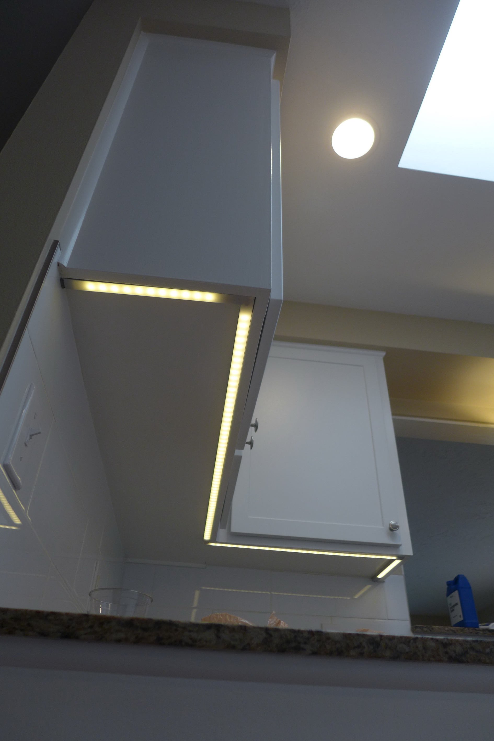

Peter Rawlings
I've messed around with LEDs in retrofit situations quite a bit. It's been a learning evolution. I like to boil things down to viable, repeatable systems from as few sources as practical.
Some bullet points:
Early on used line voltage switches and dimmers for control. Far easier to do on the low voltage side of things.
Switching and dimming can all be done after driver. It can be discrete because low voltage doesn't share the requirements of line voltage. Junction boxes, big wire etc. all out of the picture.
All LEDs strips are not equal. Lumens, quality control and expected lifespan can vary wildly. Tresco and Loox lead the way in quality and engineering. Tresco for me because it's locally stocked and they now cover nearly all the bases supply, installation and control wise.
In under cabs, I put all in channels with lenses now. It diffuses the light and gets rid of the snaggy, vulnerable raw strips I used early on.
Despite Tresco having couplings and elbows and such to connect, I've some to solder many connections because it offers more flexibility.
I typically run channels on upper cabs at the front with returns to wall at finished ends. Running channels at back close to wall will highlight weirdness of backsplash. Can look especially bad with small tile.
Just used Tresco's FreeDim wireless control system. Very cool and it eliminates figuring out how and where to wire switch...'cause it's wireless!
I usually steer clear of the higher Kelvin numbers. Things just look better and warmer in the sub 3000 range.
