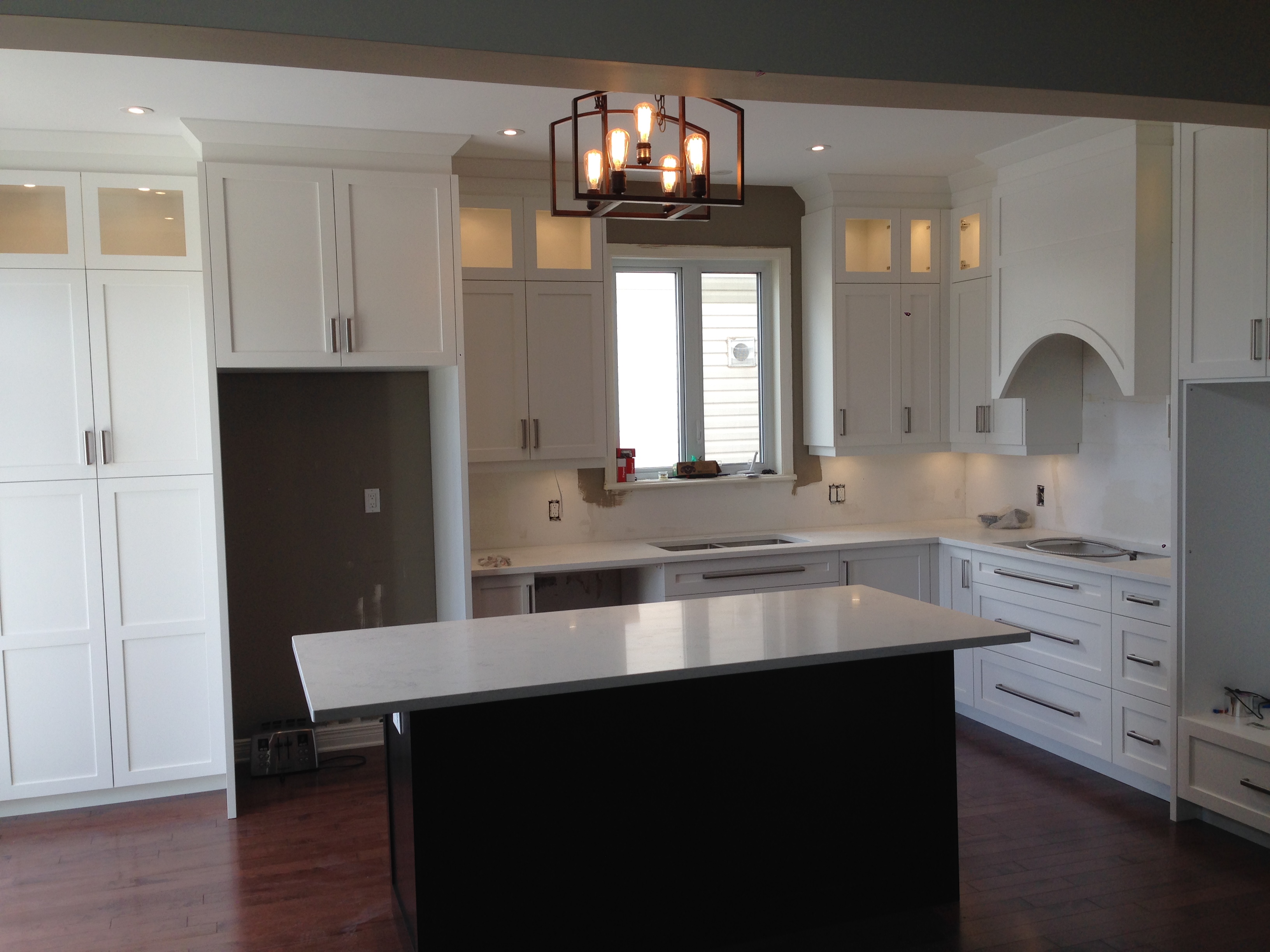

Hi all, so we just finished a kitchen install.
Customer is very happy but she noted her attention goes to the gray blum hinges in the glass cabinet, which are sprayed white on the inside. She is wondering if there's anything we can do about it, I had the thought of spraying the hinges white, but never seen them sprayed before.
She is not asking for it to be fixed, but this has never come up before with any other client, and we've done plenty of glass doors, so I'm just wondering if anyone has had a similar experience.
I attached a picture that kind of shows the hinges

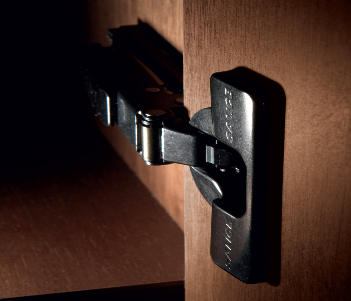

Hi Mike Fuson,
Glad to hear you are on board with our Titanium plated (ORB) hinges.
Have a great day,
Dennis

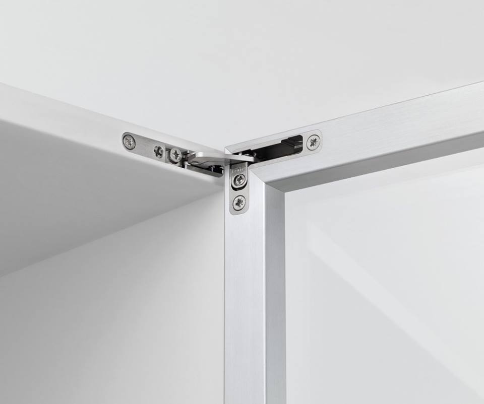

Hi Dan,
Thanks for mentioning the new Salice Air hinge. This is indeed the next evolution of concealed hinges that truly makes them "concealed". By the way, the Air hinge was a Challenger's Award winner for innovative new products at the IWF show in 2016.
Have a great day,
Dennis
