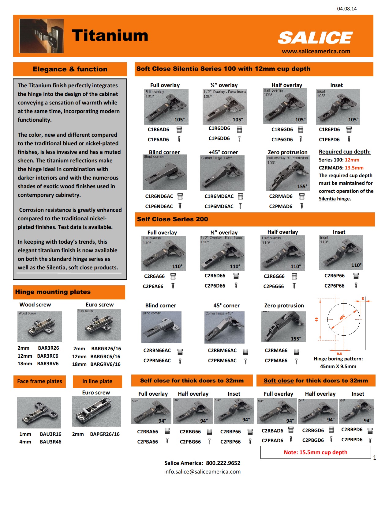

Is this in an outdoor environment where stainless might be the best (only) solution? If not, the Salice Titanium plated hinge offers a corrosion resistance 3X that of the normal nickel plated hinges. This is not to say that it is corrosion-proof like stainless but it could be another solution if the dark color is acceptable to your customer.
