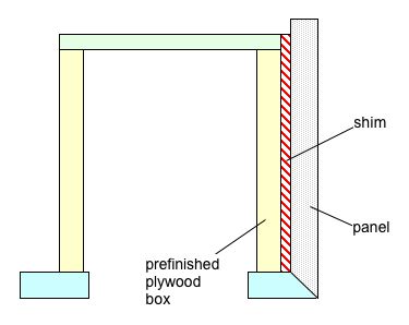

We build a cabinet that has end panels mitered to faceframes. The box itself is either made out of pre-finished maple plywood or if the cabinet is paint grade out of raw plywood.
We need to come up with a better way to affix to the end panel to the cabinet box.
We currently juxtapose the faceframe to the box however meets the condition we need to see on the inside. What we struggle with is how to shim and affix the end panel, particularly to prefinished plywood.
The distance that needs to be shimmed varies depending on the situation. Our current strategy is to produce shims as necessary then affix them to the box. If the box is prefinished plywood we first abrade the plywood with a hand held belt sander so that there is something for the titebond yellow glue to get purchase to.

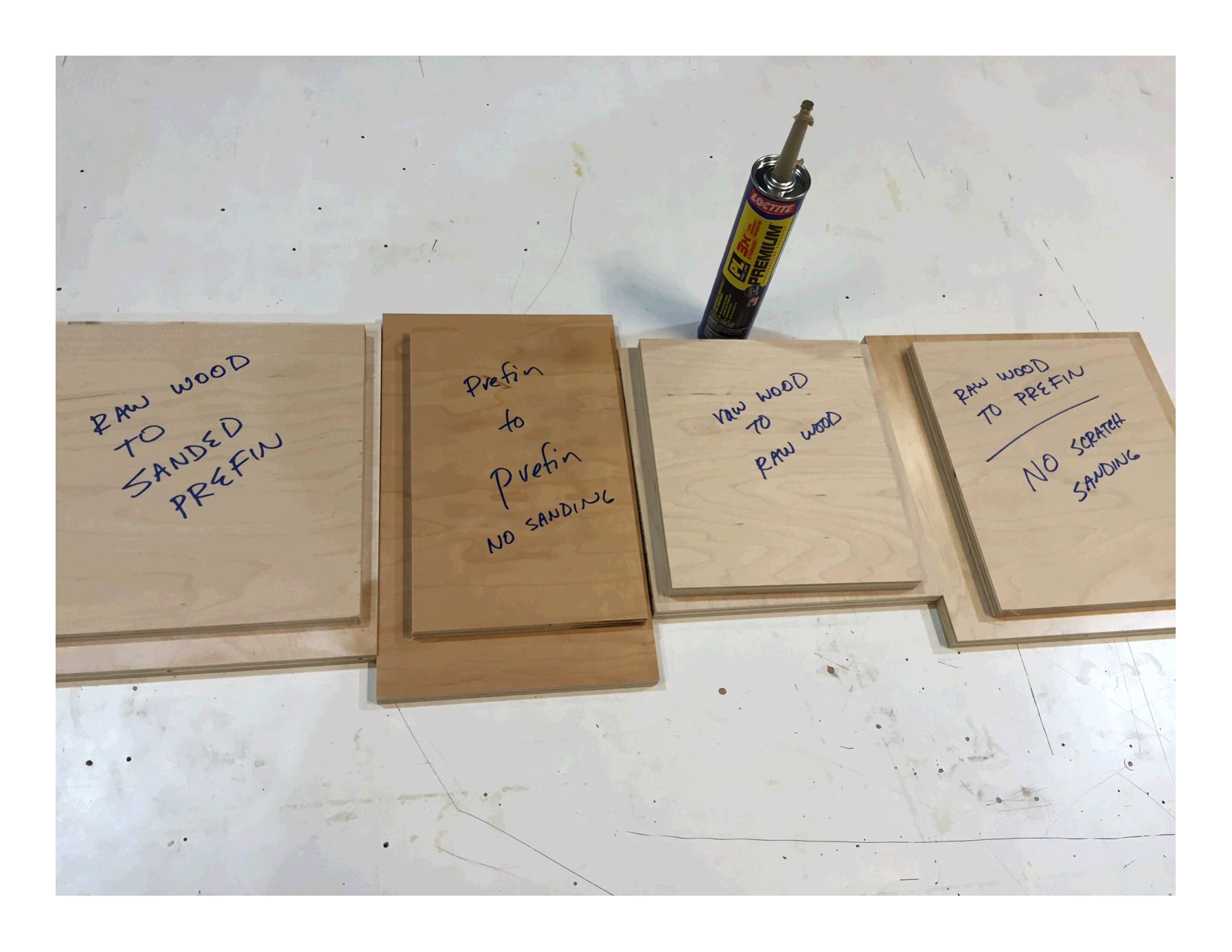

Cabmaker
Pat,
That is a great glue! I brought some in and did the following tests.
The glue pattern was a simple square pattern around the perimeter with an "X" in the middle. The only clamping pressure was an initial push together with my fingers.
We tested this with:
A) Raw paint grade plywood >>> Scuffed up Pre-fin plywood. The scuffing was a quick dust with a handheld belt sander at 80 grit.
B) Prefinished plywood >>> Prefinished plywood. This was just as it comes off the truck
C) Raw paint grade plywood >>>Raw paint grade plywood
D) Raw paint grade plywood >>>> Raw prefinished plywood without any intermediary scratch patterns on the prefin.
View higher quality, full size image (1794 X 1386)

As I said before, there was no clamping pressure other than what you could apply with your fingertips. The gluing time was about 18 hours.
We then tried to pry these apart laterally using a lightweight clamp, a bar clamp and a hammer.
Nothing would make the joint budge.

Note that our attempts to separate the pieces were all on the Prefin >>> Prefin sample. Our reasoning was that this would intrinsically be the easiest joint to break.

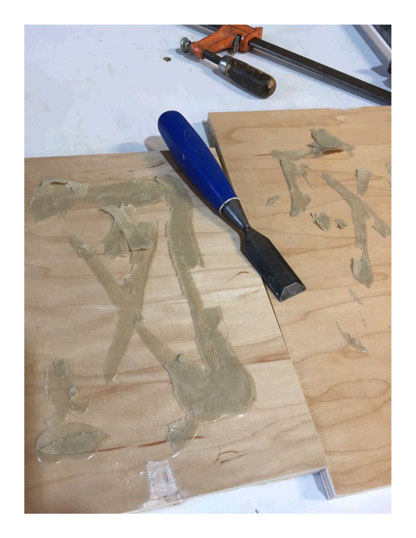

Cabmaker
We were finally able to separate the parts when we drove a chisel through the joint as a wedge.
The pieces popped apart nicely and you could pull the glue off the prefin with your fingers like it was a simple butyl caulk.
