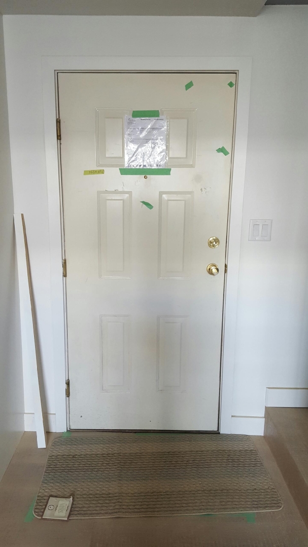

client asked if i can make the back of this metal entry door flat for him. I'm aware that buying a new door is probably cheaper but this is an entry door that is owned by the buildings Strata and can not be removed with out a lot of headache.
I'm worried about the voids in the raised panel and the air trapped inside after skinning this with a flat P-lam,
could i just use a GP P-lam or would putting at least a 1/8 hardboard substrate layer be better? would bubbling still be an issue if i use a 1/8 hardboard or MDF because of the trapped air inside.
i dont want to use anything thicker than 1/8 just so his old hardware can still fit, again getting new hardware is not an option here.
the attached image is the door in question.
thanks for any help in advance.

Drywall mud??

It could be done.
Since it is metal, think of it like a car hood, door or trunk with many large dings. Scuff sand concave areas to remove existing coating to get to bare metal. Use auto body Bondo. May take a few applications--1/4" thick at a time. Final fill to just above flat surfaces, sand smooth, prime and paint. Probably more in labor and materials than a replacement, but that is how I would attack it.

Easy. Formica the thing.

Bondo the voids. Laminate.

For a little extra cost...I always use Rage Extreme body filler by Evercoat. A lot better than Bondo.

NAPA makes one of the lowest cost prograde bondo type fillers. It has glass microspheres as the thickener instead of talc like bondo. It's about $25 a gallon NAPA Microlight
