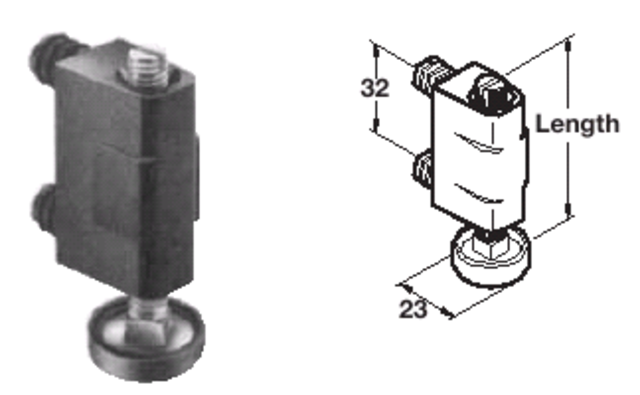

I'm lookng for better way to level our floor mounted closet units. Moment we use shingles to shim the units upward, but can be a little clunky, particularly when you need to start stacking shingles, or are trying shim and end unit thats against a wall and are needing to cut the shingle to length.
I'm considering trying out something similar to what's shown in the attached screenshot. All of our side panels go the floor, and units are wrapped with a base molding to cover any gap at the bottom.

if i understand your process correctly then the Camar levelers we use could also work for you. they are cylindrical legs that get drilled into the bottom of the panel and adjust through a 5 or 6mm hole in the side of the panel (which would be covered by your base). i have always bought them from Peter Meier.com here is the link, below.
we use the 12mm ones which need a minimum panel thickness of 19mm.

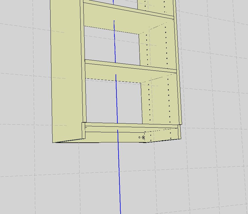

Thanks. I've attached a screenshot of how our units are put together, this is a rear view of the base of a typical unit. The sides and front kick go to the floor, but the deck is 2 1/2" up from the bottom of the sides. We use to use the Camar levelers for cabinets, but can use them here, as the deck is elevated.

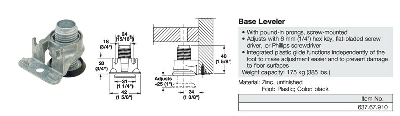

Grab a Hafele catalog, lots of options - e.g. 637.11.320/348 (60/80mm).

i think if you used one of the taller sizes of camar levelers that would locate the adjustment hole above your deck surface.
you could put them in line with the shelf pins and it would be unnoticable.
