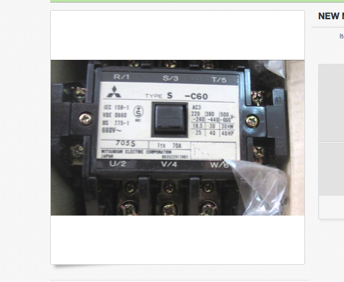

We are looking for a magnetic contactor for the widebelt sander in the title.
Attached is the photo of what we need, we have found 2 examples of it for sale online but both stores are out of stock.
Does anyone know where we can buy one or find a different brand of the same contacter?

Normally a search for the part number is your best bet. Otherwise you'll probably have to get a different brand with the same specs (control voltage, # of poles, etc) and just make it work.
Are you sure the contactor is bad? You can take them apart to inspect the coil and the contacts themselves. Dust build up between the contacts is common, especially on sanders. Simply cleaning them can fix the issue. Is it pulling back when energized? If not, have you checked every relay/fuse/wired connections with a multimeter to make sure the contactor is getting power?

Any good electrical supply house will have something comparable.

JP Member
^^ This.
Take the old one with you if you want. You are after a definite purpose contactor. Most heating and air or electrical supply places will have a pretty good selection.

Mark V.
My first stop would be eBay.
