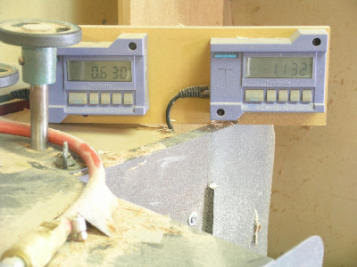

As for converting, we keep ours on decimal inch, and now have some digital readout calipers to use, and we are now decimal. We do have "Fraction Inch to Decimal Inch" cheat sheets taped to a couple of machines (handed out at equipment shows, etc), but we use them less now than when we first set up with the Accurate products. We regularly talk about sizing a tenon "8 thousandths under the mortise" or similar, and know what we mean. Our accuracy and repeatability has greatly improved. No more "a half a hair more".
The photo is of the top and bottom head readouts on our ancient tenoner. Both read off the table. They reduced set up time from a very iffy 20 minutes, "that's good enough" to a precise exactly what we want with the first piece in 5 minutes or less. Doing this about 50 times a year saves/makes us $1,250.00 per year. And that is on just one machine.

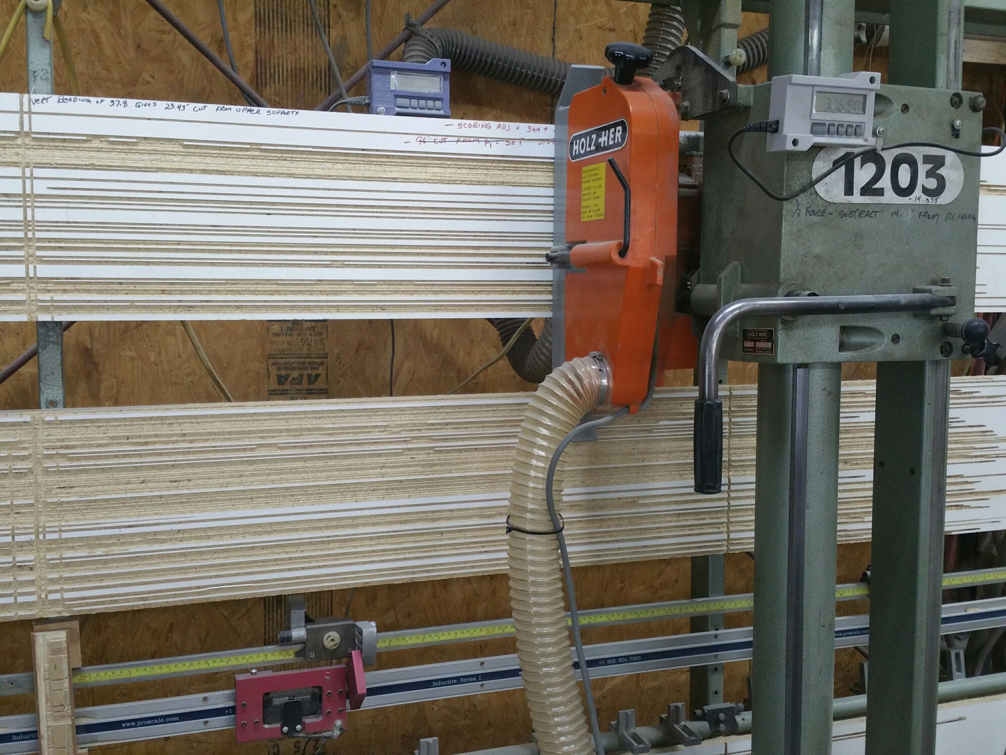

Nathan I will post a photo tomorrow. I have Proscale on both horizontal and vertical axis. I have an older Holh-zer 1203 and can not attach the proscale to a stop because the stops can not slide beyond the verticle frame supports unless they are physically removed and repositioned left or right of the frame member. I just have a stop between each of the vertical members and slide the proscale to the needed position and the stop limits its movement,

Nathan the display on the left is for the horizontal position and the display attached to the head is for the vertical or rip position.
Jr

It helps if you don't forget to attach the photo
View higher quality, full size image (1992 X 1494)
