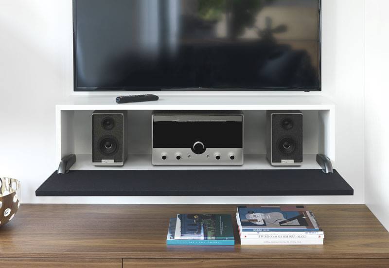

I am working on an estimate for a customer that want's cabinets that have doors that flip down (almost laying on the counter)then slide back,with a dampener so the door doesn't slam down on the counter when opening.The doors will be approximately 4' wide,2' high.Has anyone here done anything like this,or know how to make this happen?Any help would be appreciated!

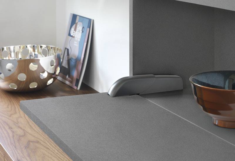

Salice has a “soon to be released” hardware item that would be perfect for what you describe. Although we have not yet released the "Pacta" officially in the U.S. it received rave reviews at Interzum in Cologne recently. Pacta offers a soft-down feature and has the possibility of a “Push” to open feature for handle-free doors. The assortment of decorative covers adds a contemporary finishing touch. Here are photos and a You Tube link to an installation video.
Jim is also correct. Both Hafele and Sugatsune have some traditional hardware items for this application.
