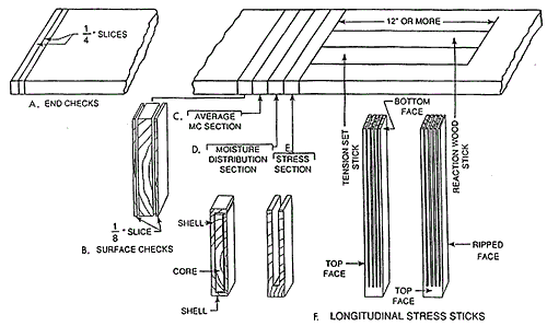

I have read in Hoadley and from Dr Gene that lumber shows internal stress - movement at the ripsaw - from only two causes.
One is that there is internal stress in the tree/log/lumber. There is nothing the woodworker can do but make shorts or kindling. But this is somewhat rare.
Two is internal stress induced by the drying process. This is far more common. Drying takes natural gas/money as well as some skills different from woodworking, so is vulnerable to cost cutting, etc.
I learned to do a case hardening test on lumber before unloading any semi-load when my employer bought cheaper loads. Several boards were tested. If they showed signs of case hardening, the load was sent back.
cabmaker - Have you tried a case hardening test on several boards?
I link a Woodweb discussion, but Purdue has a great explanation, in a pdf.
https://www.extension.purdue.edu/extmedia/FNR/FNR-132.pdf
View higher quality, full size image (500 X 298)
Woodweb Discussion
