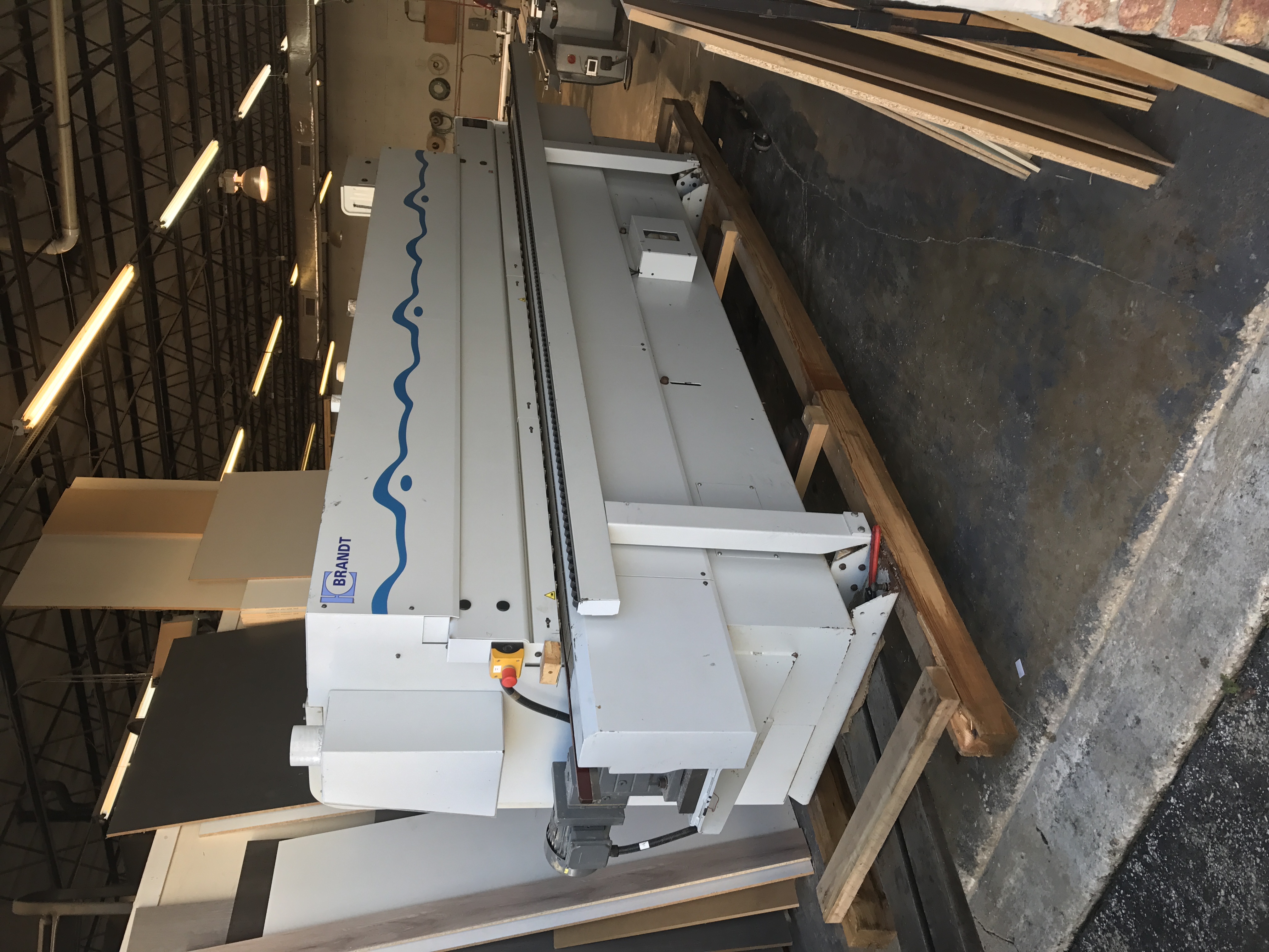

Here is a pic of a used bander we just received this past week to replace our faithful Cehisa EP-9. It has served us well for 13 years and has already been picked up to go to a new home on west coast of Florida. The Brandt has premill and end rounding and will give us a closer to glueless edge for the modern work we have been doing. Besides the high cost of Stiles parts, any tips from Brandt users you can offer? It should be set up and tuned by end of day Monday and my 4 guys and myself will be trained on using it before we hit the start button. Are replacement cutters or blades available generic for this baby? All advise welcome. Harold.

Thanks to all. It is a 2006 KDF-530C. THe premill motor bearings need replacing and there is an error that does not let the pressure beam rise or fall, but my mechanic is working on it. Harold.

Attached is a pic of my new, reconditioned Bander. Hope I made the right decision and that my journey can be helpful 😅
