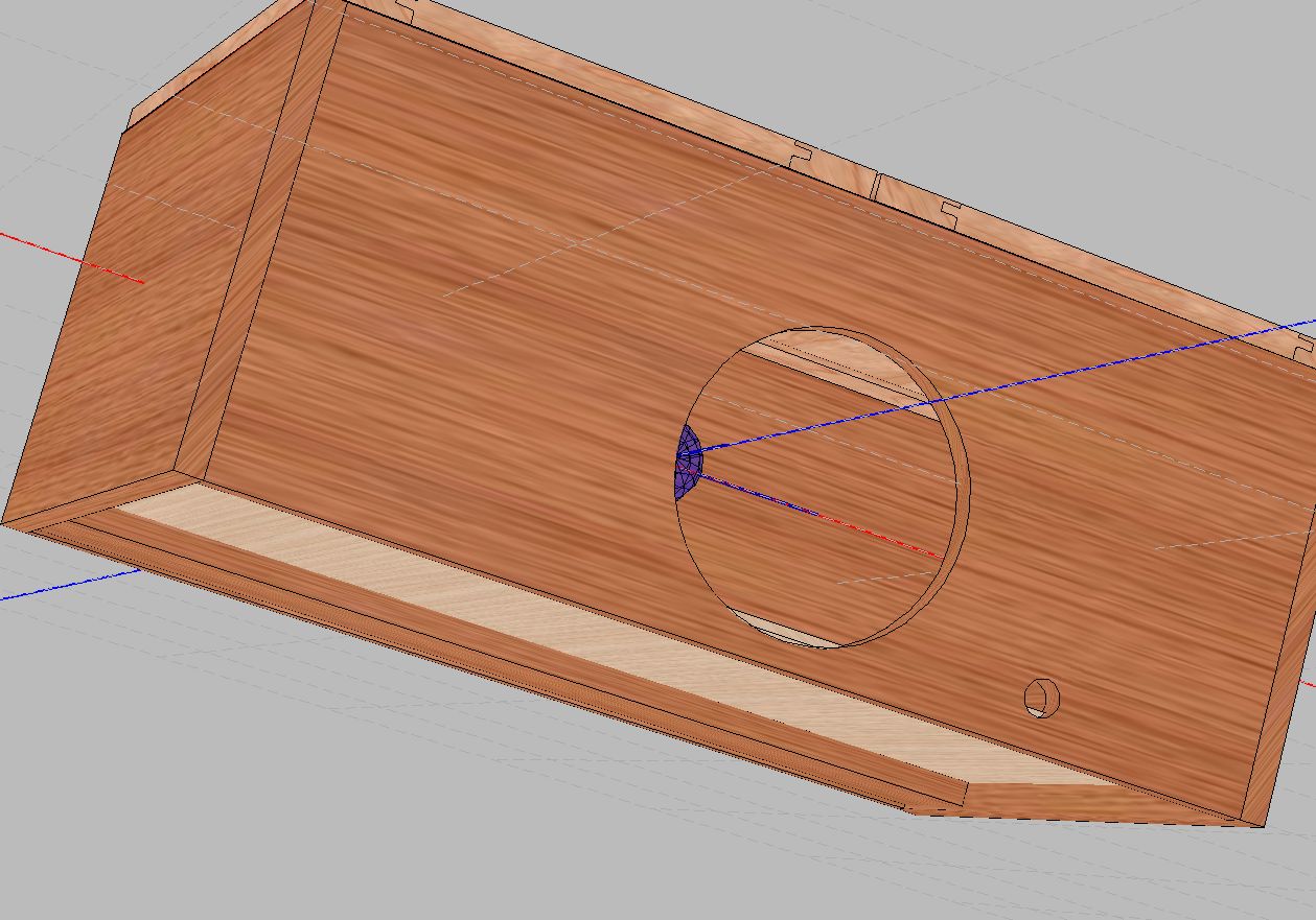

I am doing this using eCabinets and we know which vent product will be used below it, so we might as well do the duct and power cuts to the deck on the router.
Which got me thinking. Why even have a back? The cab has a 4" nailer along the top edge, so why not just have that and skip the back?
With our standard back, full dado around, 1/4" inset far enough to get the nailer just in from flush to the back, as you can see in the pic, the duct hole is a little compromised, as is the power wire hole.
