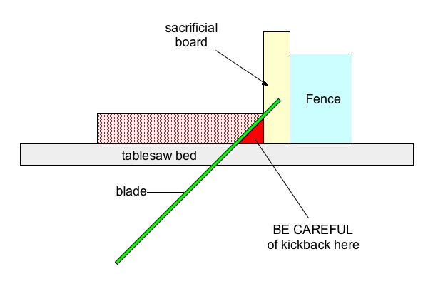

We've used something similar to Adam's method many times in the past. You just clamp a board to the tablesaw fence and bury the blade into the board.
You do, however, sometimes want to do a relief cut so that material does not get bound between the blade and board. Too much pressure here will send a scrap shooting back like an arrow.

Your drawing shows a setup almost guaranteed to produce kickback. The lower edge of the sacificial fence board needs to be higher than the cutoff to be safe.

You are right about the kickback.
That's why that danger is flagged on the drawing.
We used to have a dedicated table saw with an additional table surface that elevated the lumber. This allowed the drop off to fall to an area that did not bind.
For a one-off cut I would not add the auxiliary table surface. I would just make sure nobody was standing behind the cut.

It takes no longer to do a safe setup than what you show, so why not? Just clamp the auxiliary fence on 3/32" below the stock height and raise the blade into it.

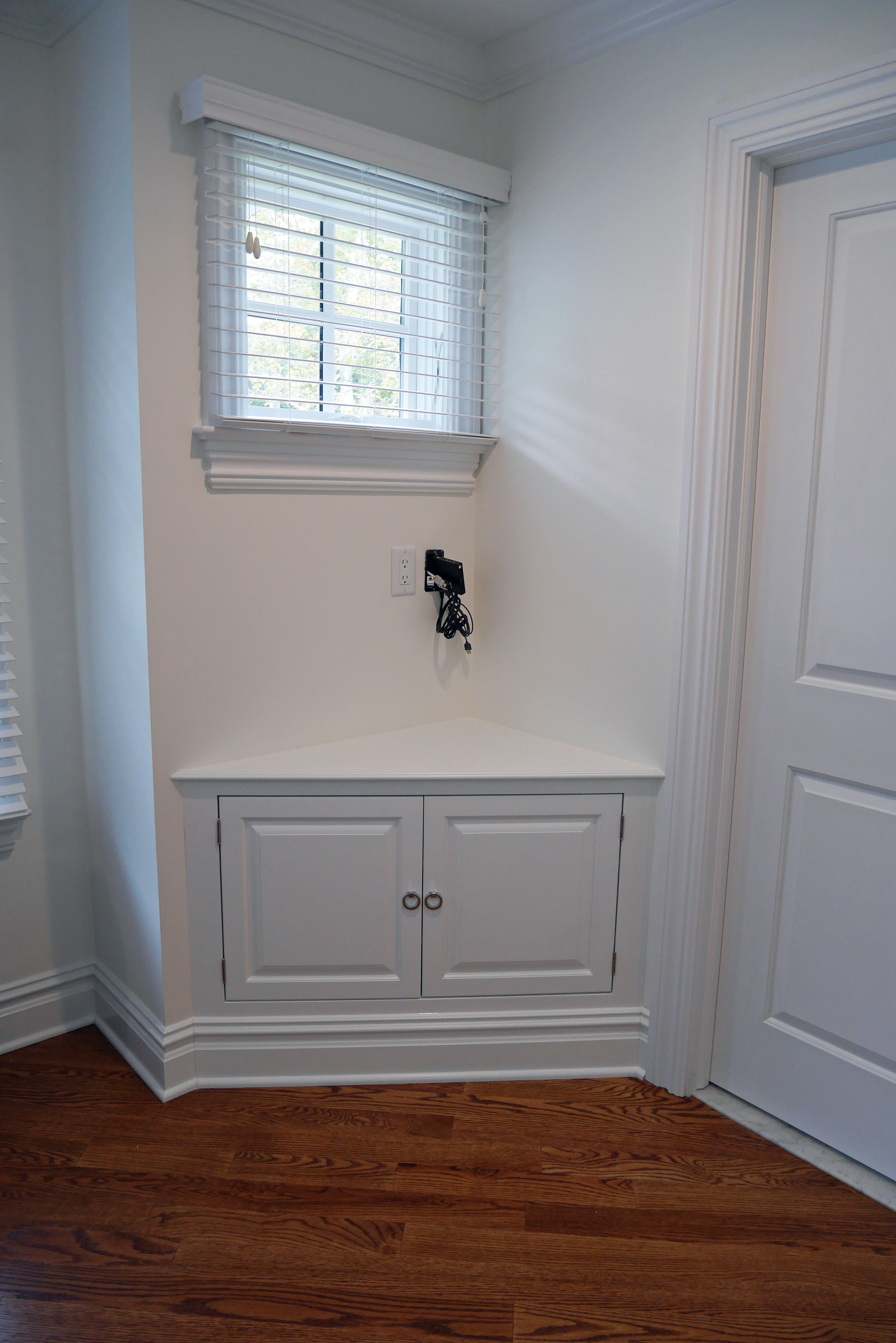

I'm guessing that you could pre-cut the miter at 45 degrees so when you run it at the final angle, the offcut would not get jammed up under the blade. BTW, installed the cabinet on Friday and it came out fine. Thanks for all the input. I'm filing it away for next time.
