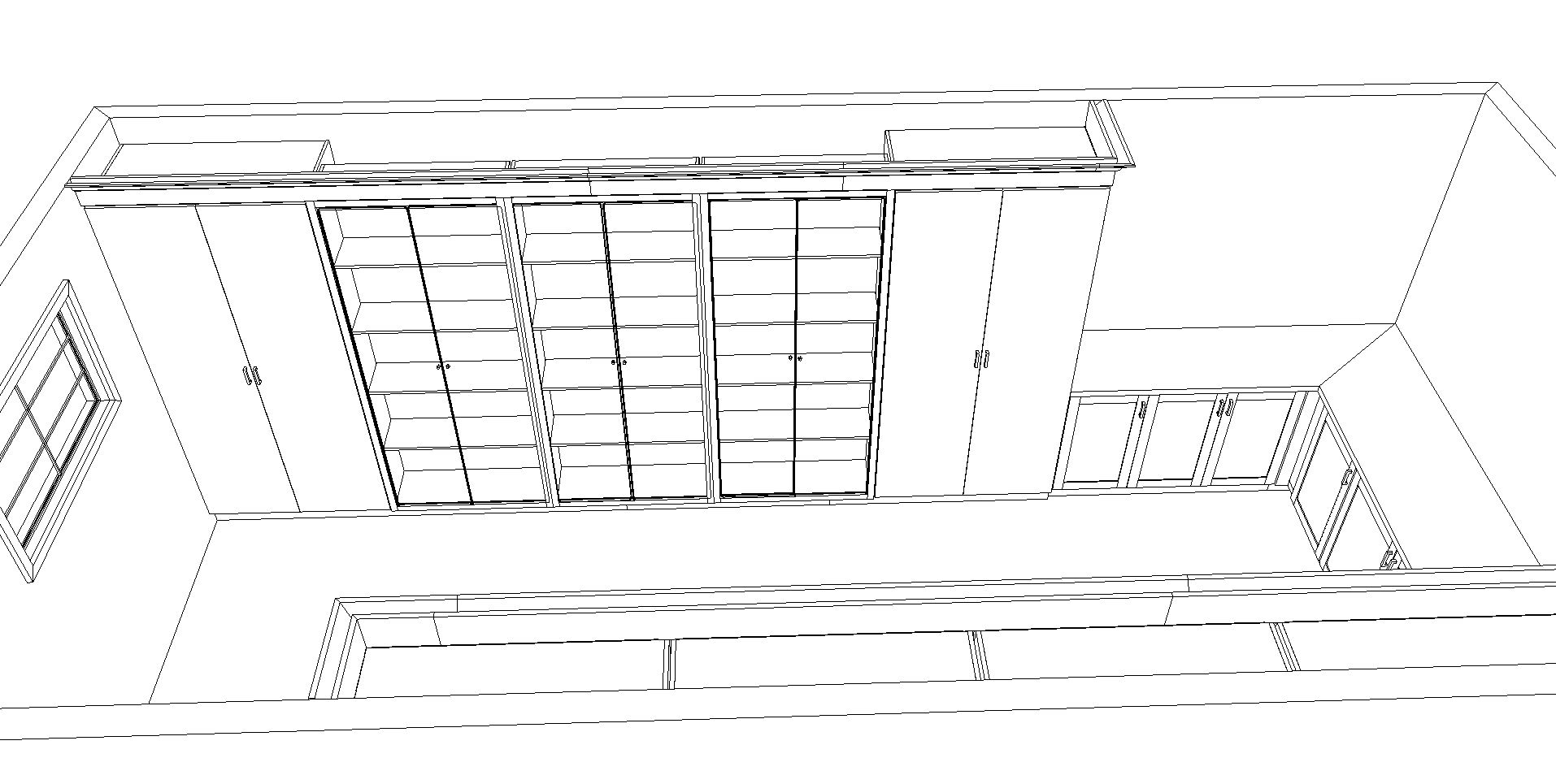

Hi everyone, I have a customer who wants a room full of cabinets to display his Pez dispenser collection (4000 of them) and the project has grown from essentially just some tall cabinets with frame-only doors, to tall cabinets with essentially glass shower doors, to a display case with glass sides and full glass doors. Anyway, it is something now that I'm not able to handle. It seems you would need wood, glass, and metal working ability's. I am/was working with an interior designer on this one...would this job be in any of your wheel houses?

Craig,
Look into these...https://www.epcohardware.com/Assembled-Packages/Assembly-16/
I've used them before in smaller cases, but they may still apply.

Alan F. Member
The number one criteria in displaying collectibles that are valuable is to use materials that have no affect on the items.
There are some fabrics and lighting for the interiors that are neutral and used for a lot of art and pottery.
There are lots of metal and glass systems that are pretty simple. They key is getting someone to choose a system beyond an arm wave.

Dan Cook
Could you make wood frames made for glass panels for the sides, which would allow for holes for shelf pins and would also give you structure to hang the doors? We did some glass showcases that wrapped an octagonal room. They had full glass doors, but we had frames on the sides with glass panels so you could see through the sides from one case to the next. We did mirror backs and glass shelves. It really wasn't all that bad. You just have to find the right hardware that will work for you. We delivered these out of state and the worst part was just getting them in the truck and to the job safely.

Bypass glass doors will not provide the dust control most collectors want in a display cabinet.

L.W.
I would firmly bow out of the job and write a letter to the designer saying that it's out of your wheelhouse, which is wood-oriented. The designer may reconsider the plan in order to keep fabrication with a known supplier (you) or may at least keep you in mind for future jobs. It sounds like too much glass and not enough woodworking to make money at, unless the pockets are deep and they're basically paying you to project manage the sourcing and installation.
