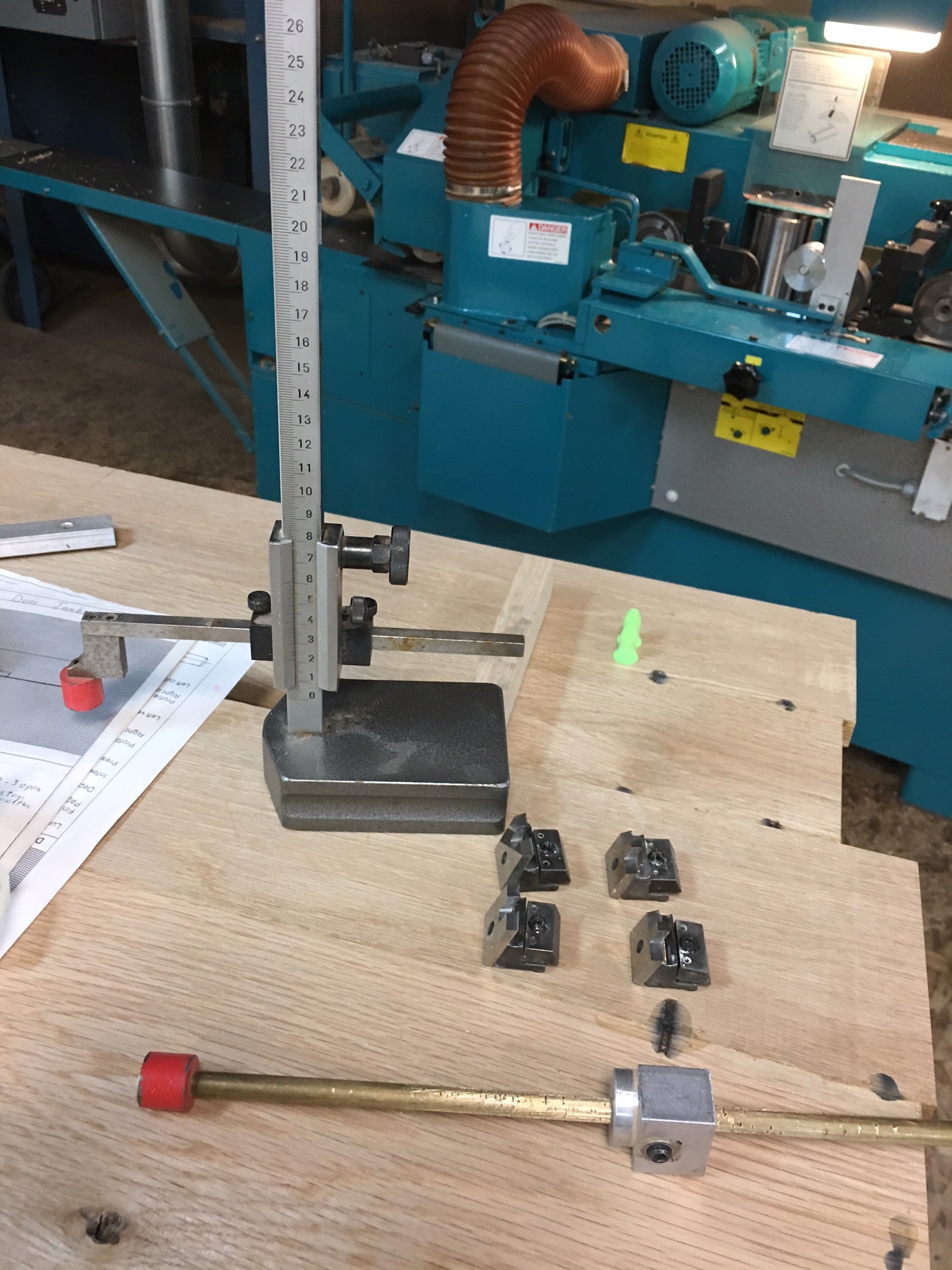

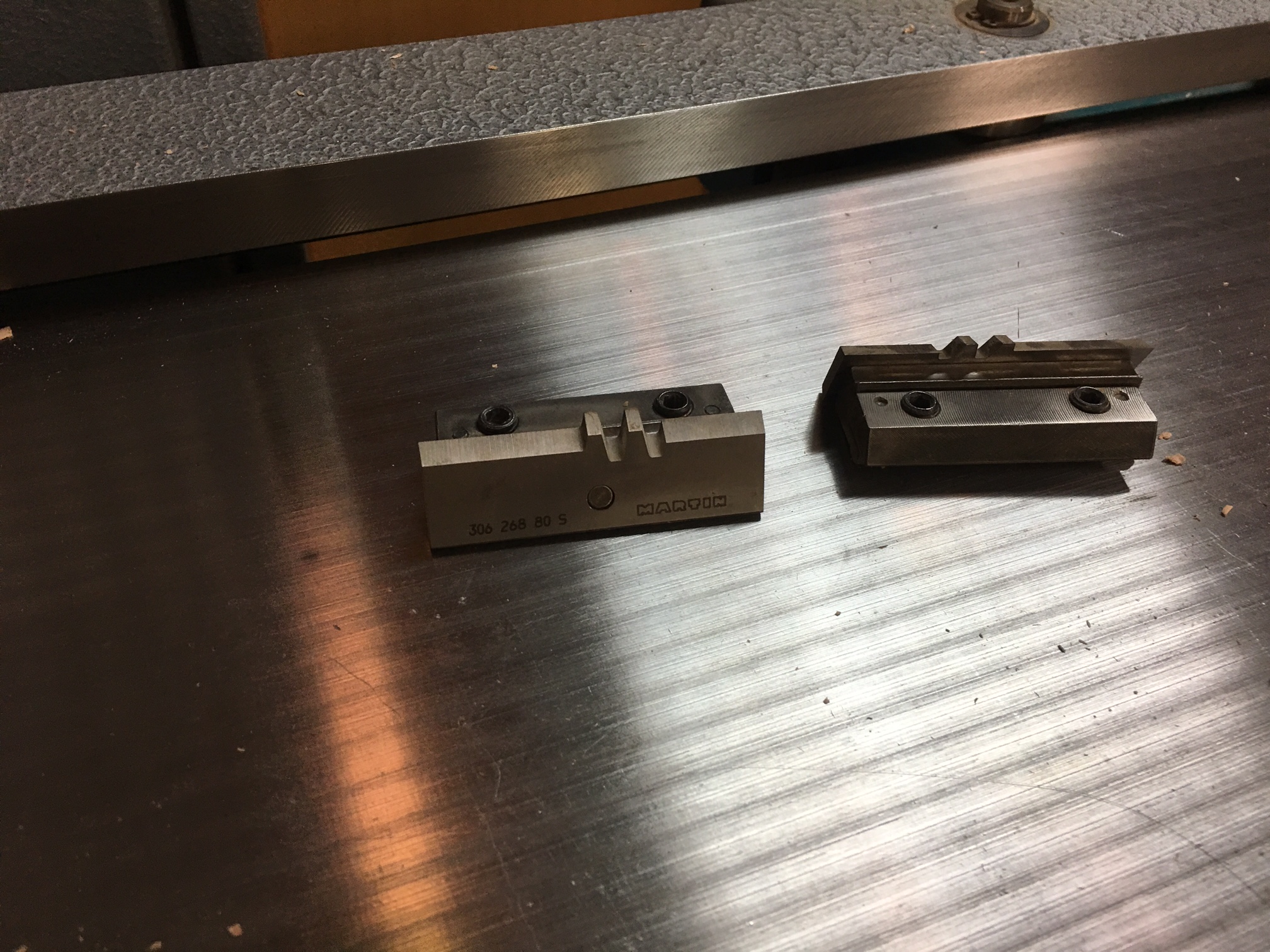

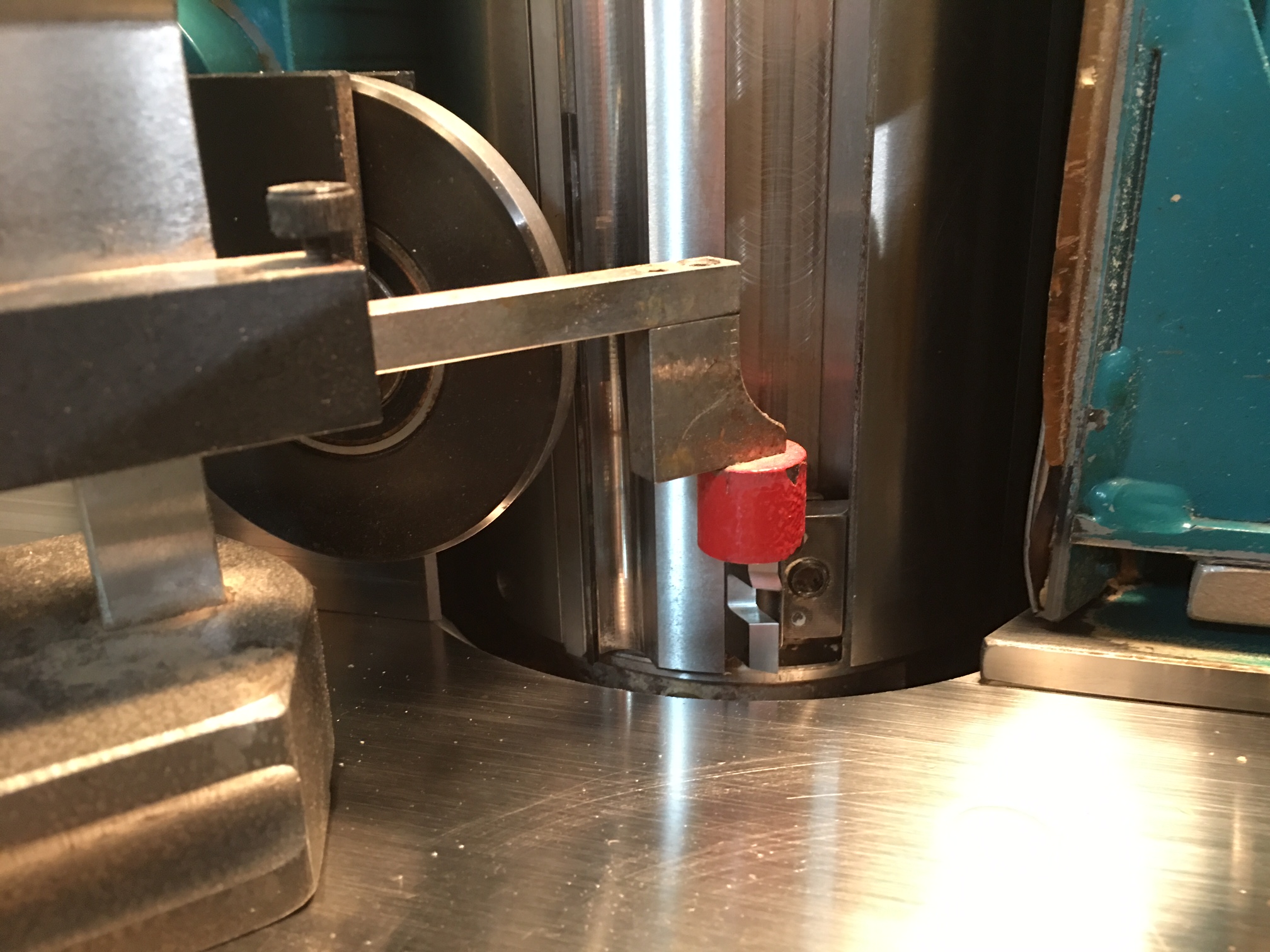

The knives I use in the T90 are unique to Martin and made by Leitz. They are inserts that go in the Tersa head with simple setting gauges.
The advantage is any setup can be made in minutes - corner rounding, T&G, glue joints, back out and the such. The disadvantage is knives take a while to get and depth of cut is limited to 12mm.
Its worked well for us though.
I believe Terminus has a similar system.
We still use our Martin jointer with spring joint function and Tersa knives for most critical glue ups. We are not a high production shop though and can certainly see the advantage of a good glue line SLR saw in some cases.
