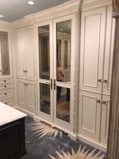

I feel your pain. When 3 doors that were somewhere around 112" tall warped on me, I dadoed a 1/2" wide slot on the edge similar to what David did with his hardwood strip, but used 1/2 x 1/2 steel bar stock bent to the opposite curve. The dado's tight enough that the bar can be pushed in and bend the door back straight, but not so tight that I couldn't get it out to get the bend just right and try again. Once it was dialed in, I shot some 5 min epoxy to keep it in place and repainted the back side. These were paint grade doors that were pretty fancy for us, and I really didn't want to remake. It's now our go-to solution when an expensive door doesn't cooperate.
