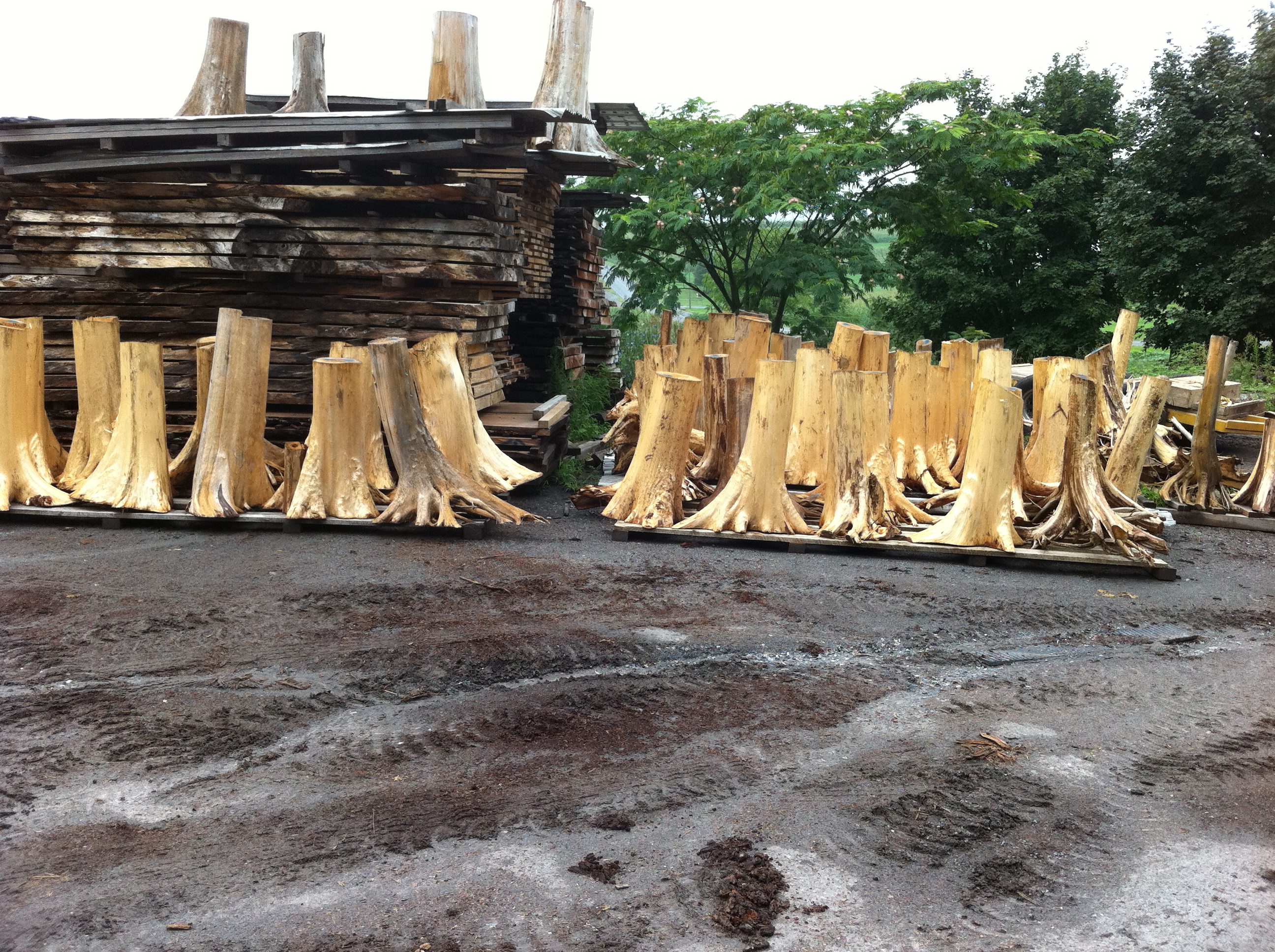

David Werkheiser  Member
Not sure where you live, these stumps are located in Lancaster, Pa.
11/30/17       #14: Peeled Tree Stumps ...
Stewart Member
Hi Everyone,
All very good responses - I appreciate the caution on bugs as well! (I have not submitted a bid or even an estimate at this point.) David, that looks very close to what I am after - feel free to message me! Approx 10" diameter and 7' tall is what I am looking for with an approximate 24" root flare. I did find a possible source - air dried to around 20 - 25%. He cautioned about bugs as well but said if they sit in a kiln at 140 degrees for two weeks, that would take care of it. Does this sound right? If I introduce bugs into someone's house, that could put a shop like mine out of business so I can't take a chance on that. Please weigh in with an appropriate kiln schedule for this! Thanks!
