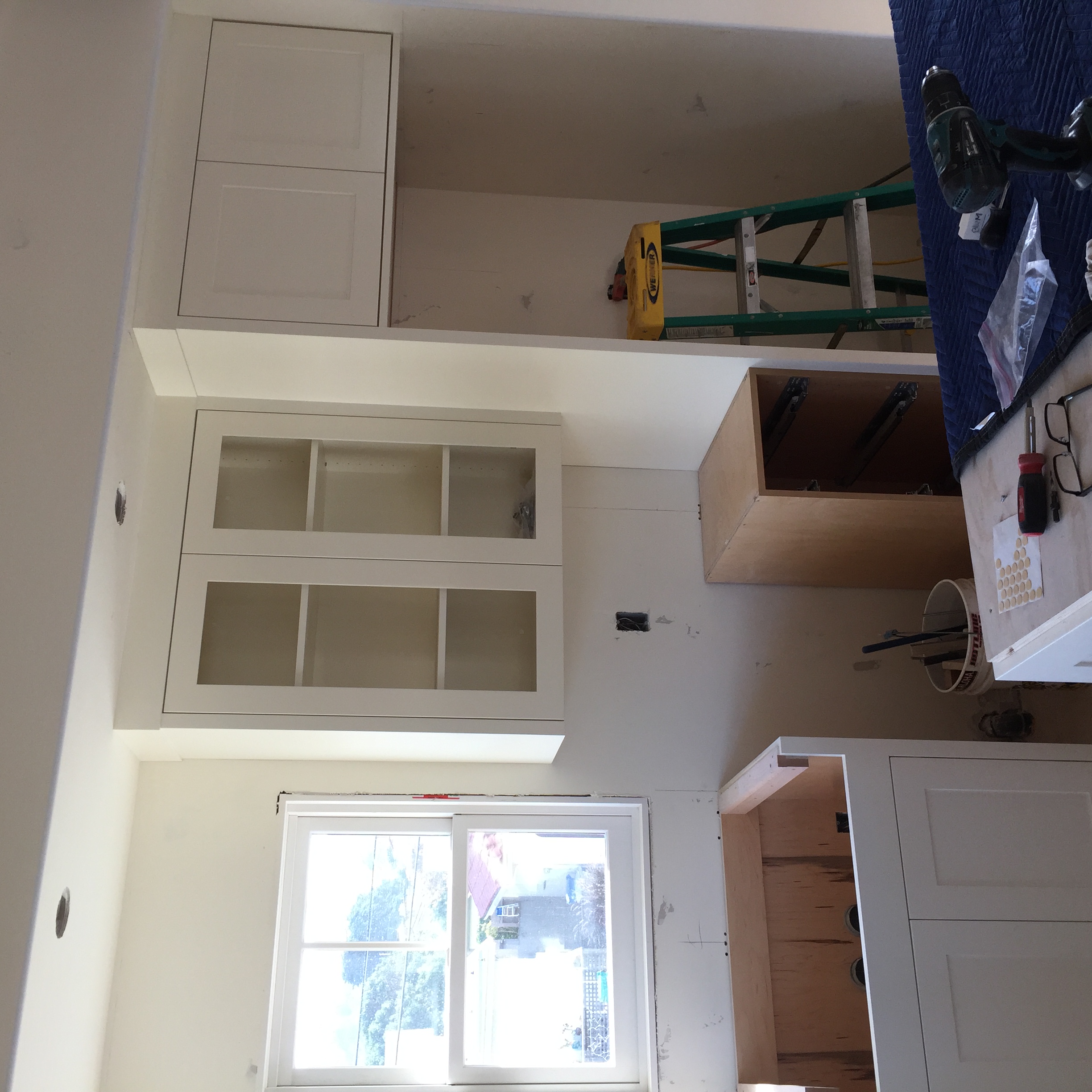

We put a 1.5” drop lip on a 4” piece of matching plywood and screw it to the under the cabinet. It adds a design element and can be totally removed or trimmed down later.

Thought about something like that Do you have a pic of what you are doing? Thanks

Here’s a photo, might have to zoom in.
