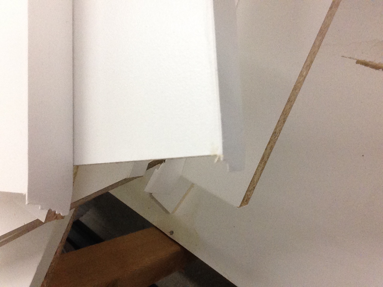

Our holzher sprint edgebander was working fine. One day the end trimmer stopped trimming the front edge properly.
The tape doesn't get trimmed and you see all the marks like the blade isn't fully cutting throut the tape.

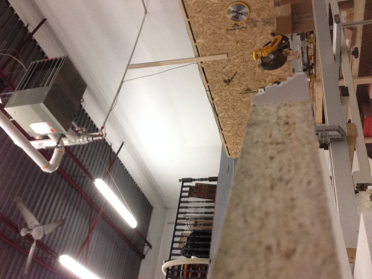

I've attached some picture hopefully someone can help. Holzher never returns our calls and I can't figure out through the manual

I've seen that when the part slips at the start when your pushing it in. Or make sure the motor is powering through the whole cut it could be an eletrical issue where the motor isn't running on full power.
9/30/17       #3: Holzher edgebanding endtrim issue ...
Jarvis

This used to happen sometimes on a Holz-Her we used to have.
The problem wasn't the end trimmer. It was the edgeband. If the band was even slightly old, or had a tight curl (memory from the roll), that little tag on the end would start to fold over as the end trimmer came by.
It looked similar to what you have-- a notchy, messy gouge.
It only did it if we were using band that had a lot of curled memory from being in the roll. And, only on half-mil thickness stuff.

We had similar issue with Biesse Edgebander. Can't speak for the Holzher, but with the Biesse there's an pneumatic cylinder that engages the end cutter, while following the panel. The bolts/lock nut holding the cylinder would come loose. Factory part was cast, worn, repaired a few times, tired and didn't hold the cylinder precisely/securely enough. Just had part replicated out of steel. Problem solved. If yours has such a pneumatic cylinder, check it. This "appeared" to be working, but just not right. Good luck.
