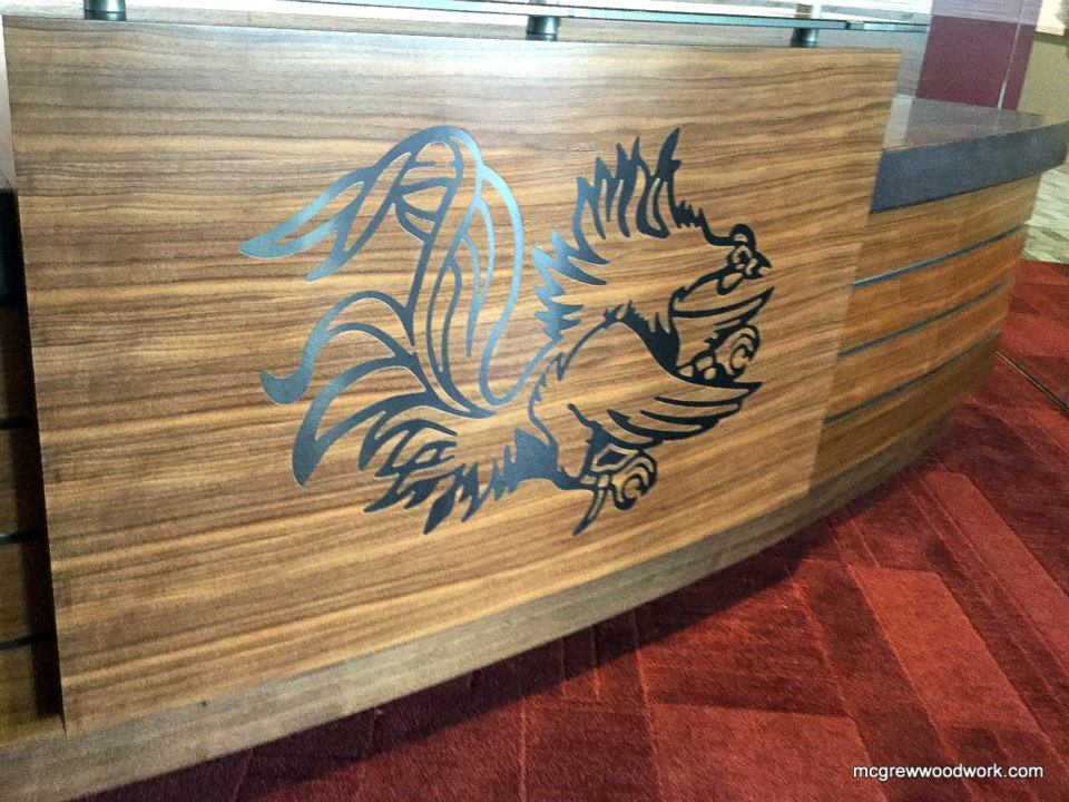

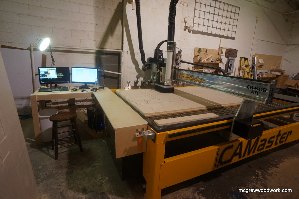

james e mcgrew Member

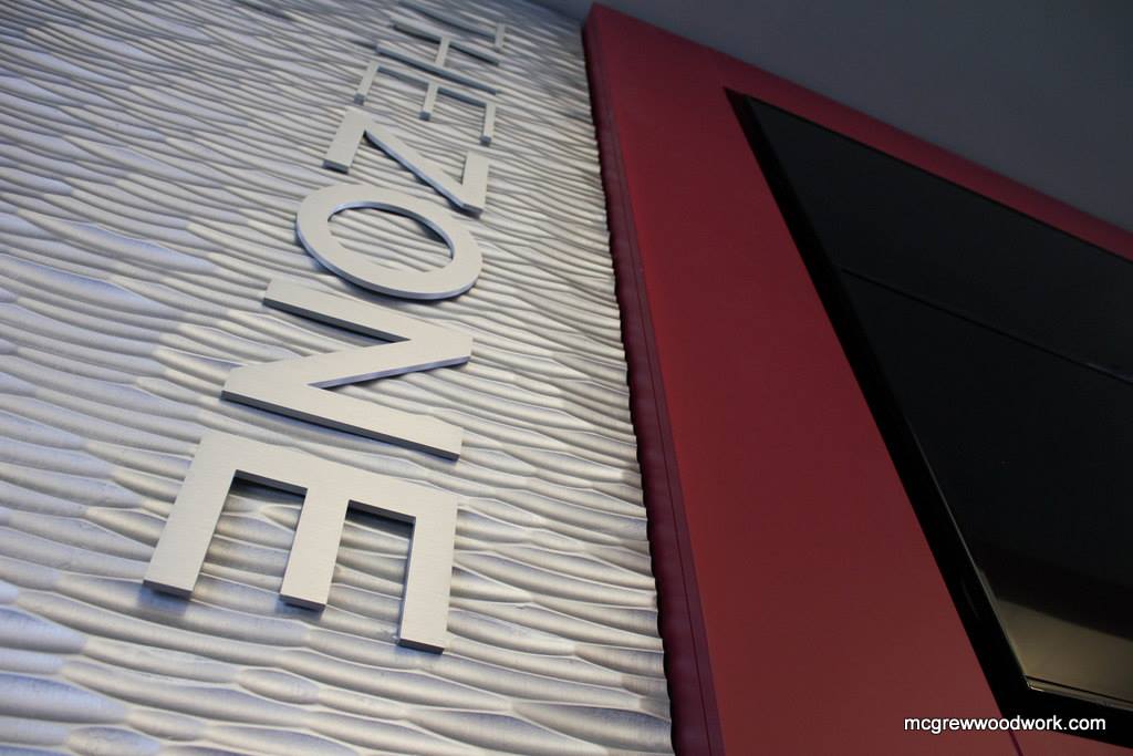

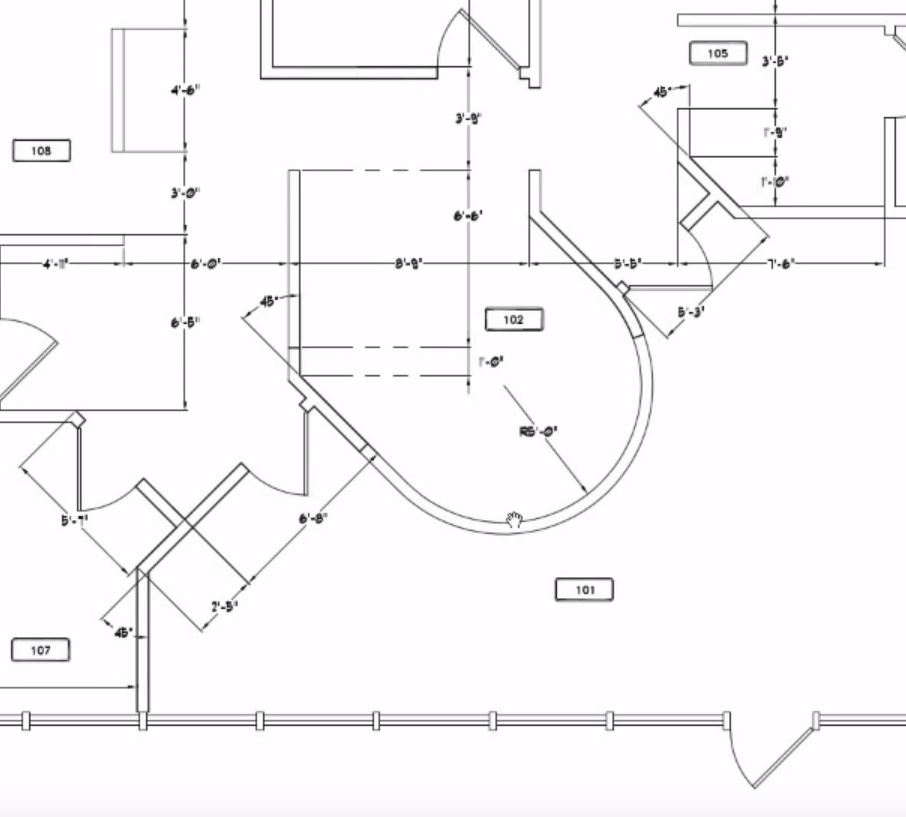

I had not seen this Video for a while but thinking of this post i looked it up, i did this a good 5 years ago and I have excelled far since then. Yet i was really tickled at how overall easy it became !
View higher quality, full size image (906 X 817)
View higher quality, full size image (960 X 720)
https://www.youtube.com/watch?v=5APCVuxhxOM
My first machine was 4 feet wide, my 2nd thu the current 5 x 8 have all been 5 feet wide, i neede the 5 feet for a lot of reasons as we now cut commercial at 61 x 97 sheets, well worth the extra money, to me a cabinet maker needs 5 x 8 table 5 zone vac plenum, good vacuum hold down and an ATC of 5-8 tools

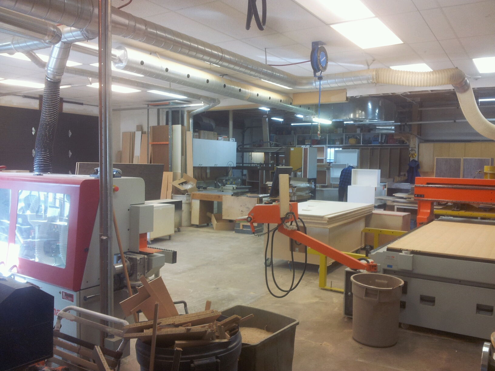

cabinetmaker
We have a decent sized shop with a cnc router, a larger bander and dowel/insert, we run a lot of commercial casework and lots of corian I am getting ready to get a cnc saw for our stone shop @ the end of this year for the automation
We own two forklifts, the Blum machines we added 20 years ago came with the same " why did we wait so long ?" same as the edgebander, wide belt and then the cnc. We run CabinetVision, again beating our heads against the wall we just went to CV10 and hear the what took so long ? We have 5 seats and 2 s2m keys. All of the upgrades and all the equipment has been great, but hands down the cnc, soft ware, bander and forklifts have saved us years on our bodies
So my friend runs a hi end residentail shop and would never buy a cnc, I cut a house full of cabinets for him with mine in 4 hours, And I am talking 40 plus cabinets He bought my older edgebander, a cnc and now uses prefinished plywood, outsources his doors with Walzcraft, does all his own finishing and pays one of my installers on the weekend to help him goes through guys like water, but the cnc keeps cutting

Get a auto toolchanger. Unless it's just a hobby machine, you're going to be really really glad you did.
CNC is bunch of money to a new buyer and a bunch of learning and messing around at first. You will probably change some things on how you build your boxes.
