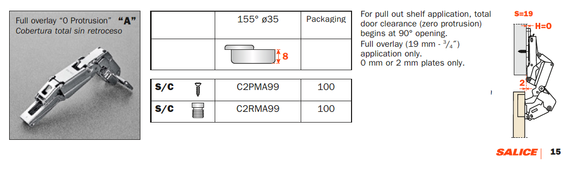

Why not use zero protrusion hinges and leave the slides tight to cabinet sides?

Ed, what exactly is a zero protrusion hinge? Most of the work I do is either frameless or inset faceframe, so you always have to pack the hinge side to clear the hinge, or the door.

Matt,
I don't know anything about a screw-on version. I am minimally familiar with the X-bracket as a friend owns the company.
Regarding a "0" protrusion hinge. This is a 155 degree opening hinge that, when opened to 90 degrees and more, prevents the door from encroaching into the opening of the cabinet and interfering with rollout shelves.
Inset doors cannot be "0" protrusion simply by the obvious nature of the construction.
Dennis
View higher quality, full size image (1144 X 352)
1/12 #9: Slide packers for rollouts. ...
Dennis covered that well , they will only help for overlay doors.
