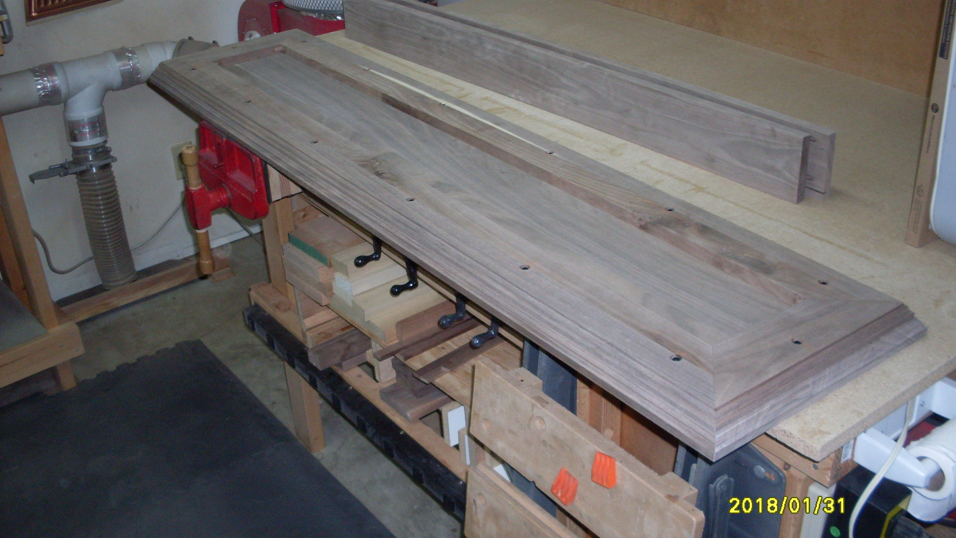

I started doing it a different way, much more work but I got tired of brad nails
and trim coming loose.

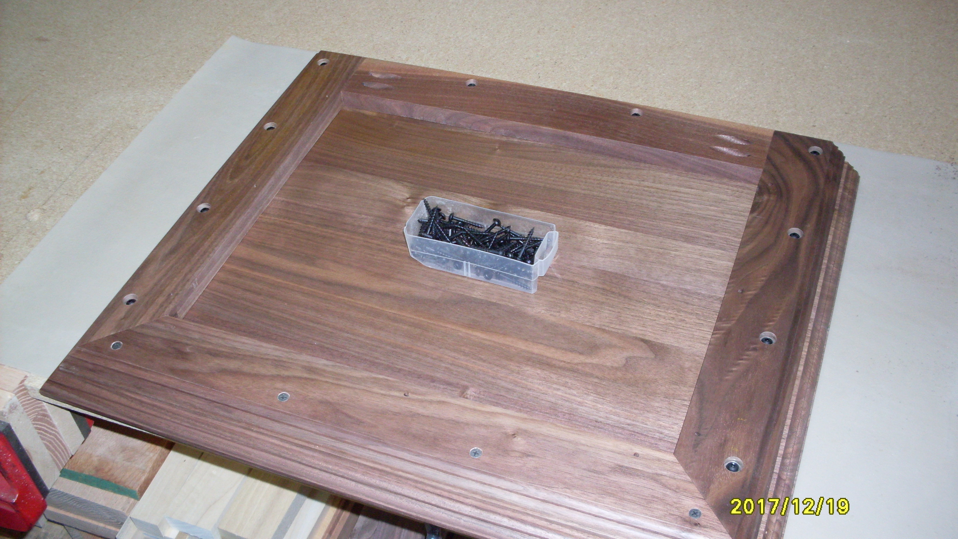

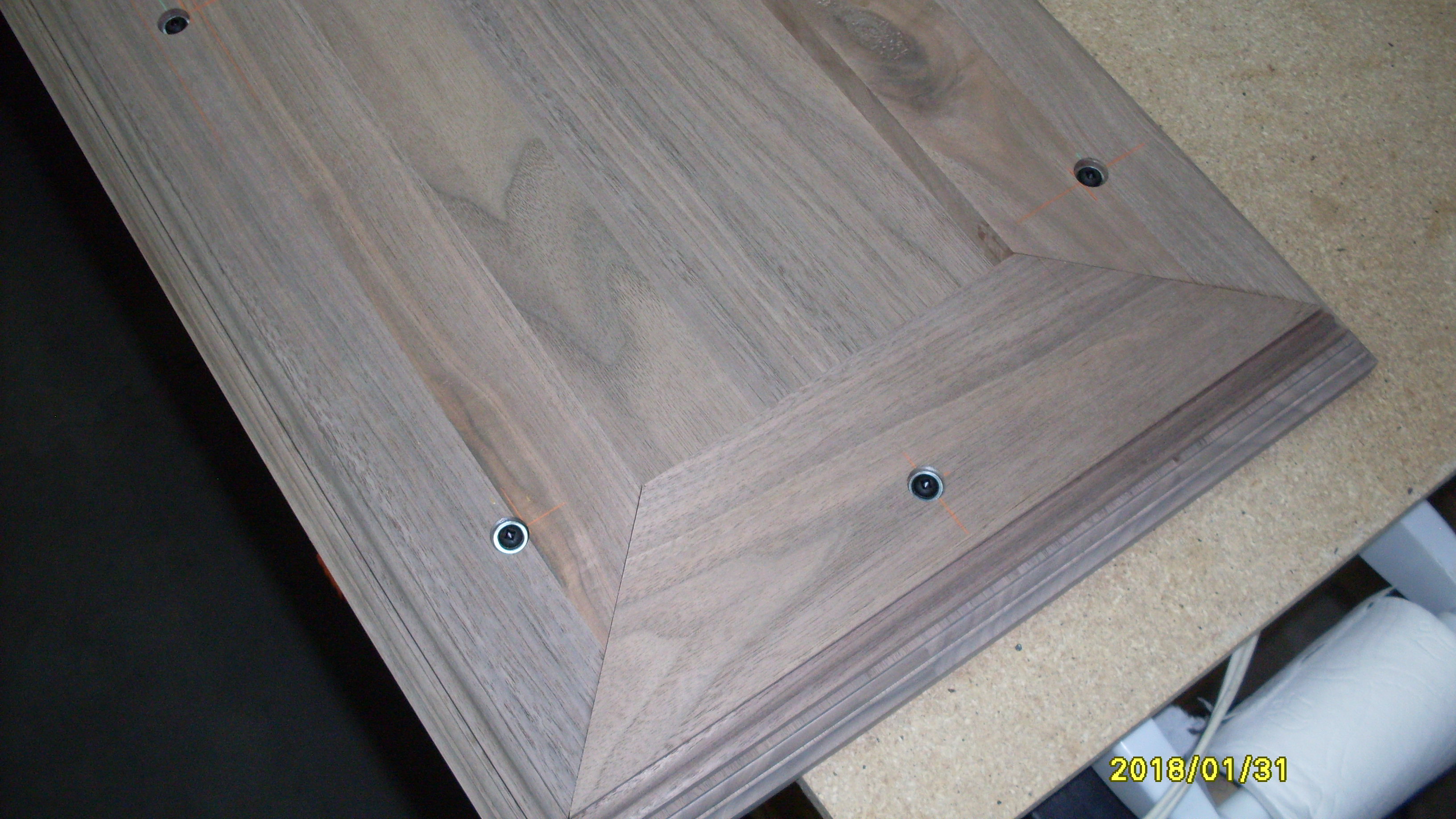

I now make a frame for my top and bottom trims. Usually about 3/4" to 1/2" thick by 2" wide.
I fasten the frame to the top with recessed screws in a oversized hole on a
washer, it gives a lot of room for the top
movement.
I fasten the trim to the cabinet with table top fasteners
Like I said, it's more work and material but works better for a higher end piece.

These pic's may show it better

It looks like this works well, however, your still fastening to a frame where it could be just glued on .. and no brads. I have fastened some trim like that in the past .. but as you have said .. more work .. I cut slots instead of oversized holes .. I may have to do it in this fashion .. just wanted something a bit easier .. :-) I will probably still glue the front miters though so they wont separate.
