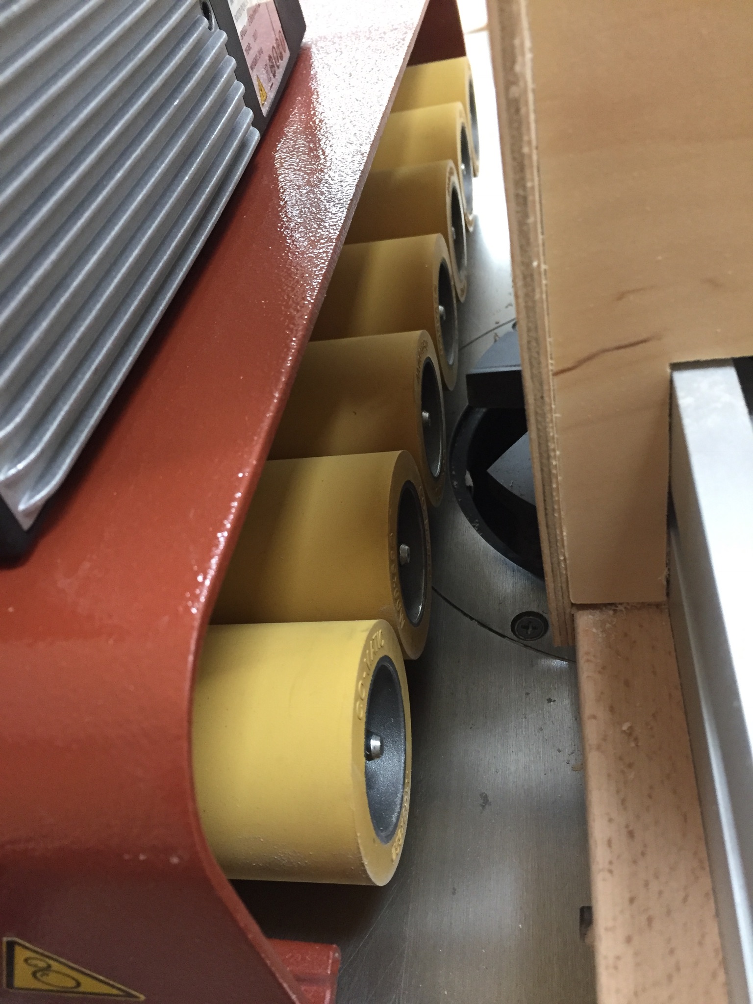

4/13 #14: Power feeder speed question ...
I took Mark B’s advice and got the DC70 by Comatic. Ran it for a while today and this thing is the Cadillac of all power feeders. It was indeed a brutal pill to swallow, but by dialing it in to 25’ per minute I’m getting really nice cuts.

Man Mike that is a lot of little wheels! Cool looking feeder! I did not know they made feeders like that. I run 8 speed Steffs and for my raised panel shapers i add on an extra wheel on the first wheel. Small parts i clamp together and run with feeder or swing feeder out the way and use miter gauge with hold down to run.
4/15 #16: Power feeder speed question ...
I was using the miter gauge on my small parts as well but with this feeder I can just back it with a wider panel and run them both at the same time, piece of cake now.
