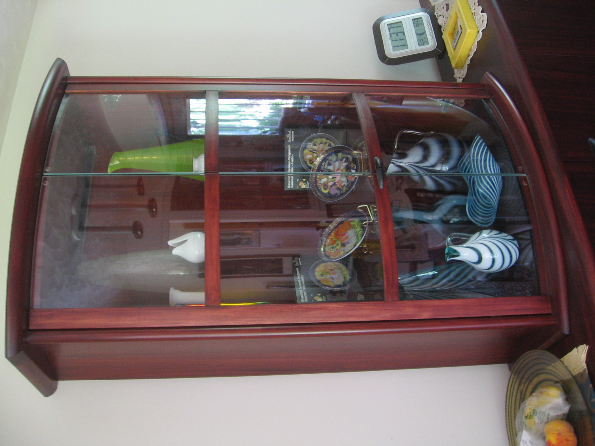

Tempered glass is not only a lot safer, it will carry something like 8X the load of untempered glass. I would want to use a dado, as Jon described. A rabbet relies too much on the glue bond. I made the glass doors in the attached photo, including the curved glass panels. The glass is glued with polyurethane adhesive into dados in the door frame stiles and mid rails. Note, there is no perimeter frame. The adhesive holds the glass. 15 years or so now, no creep, and no problems.
John
