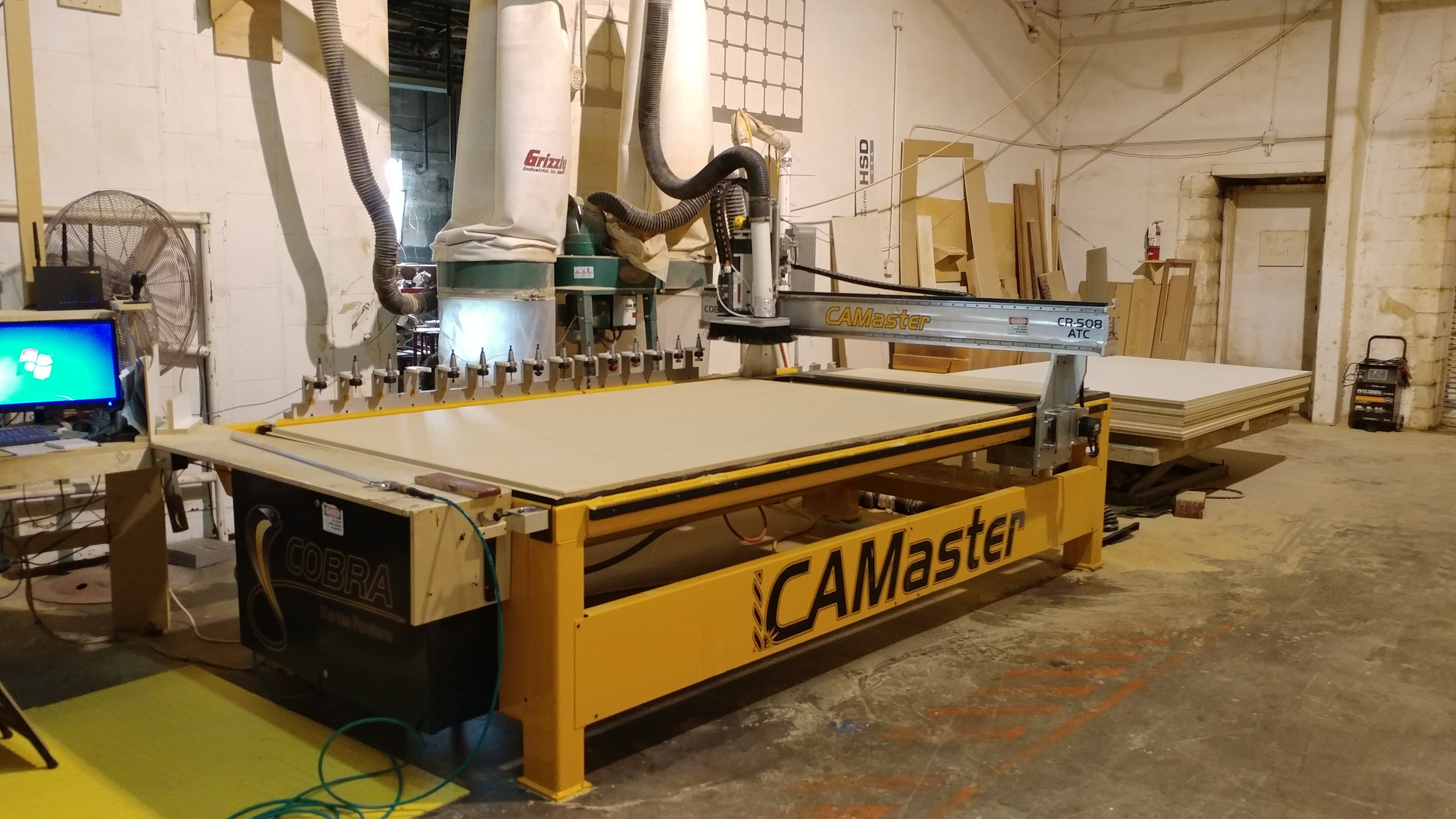

I was in the same situation in 07, not sure of current pricing but my ATC 508 was in the 40s with a 25hp vac, I added the Dust collector yet we cut 30-50 sheets a day ready for the edgebander
View higher quality, full size image (2320 X 1305)
