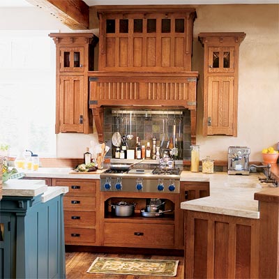

Hey everyone,
I'm new to cabinet making as I have always loved the Craftsman/Mission style. I'll be doing my cabinets in QSO and I'm looking for a fool proof traditional red color.
Can anyone please share a recipe to achieve this look on Quarter sawn Oak?
Thanks!!
4/4/18       #2: Craftsman Kitchen Stain Color ...
nicko
i have done this a few times using trans tint dyes from homestead finishing than a light sealer coat and then stain. Go to homestead finishings website and i think they have pictures of white oak with different dyes on them.
Nicko
4/4/18       #3: Craftsman Kitchen Stain Color ...
Matt Krig Member
Ask your suppliers what they offer in Ohio Certified Stains and you'll have exactly what you are looking for.
4/4/18       #4: Craftsman Kitchen Stain Color ...
Keith Newton
You'll be lucky if all the lumber you buy is QS. Most of the time there is about half which will be Rift, which is OK. Try to select the rift for the styles and rails, and use the QS for the panels and drawer fronts.
Minwax has a chestnut that gets pretty close to that.
4/7/18       #5: Craftsman Kitchen Stain Color ...
D Brown
I have used Old Masters stain and made a mix 1 part Cedar 3 parts Clear . You can go to 4 parts clear if too Red . That's an easy one, Good luck.
