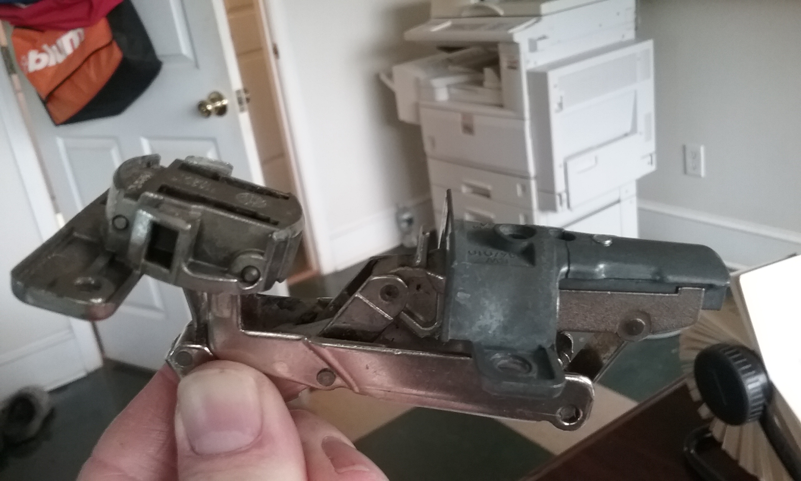

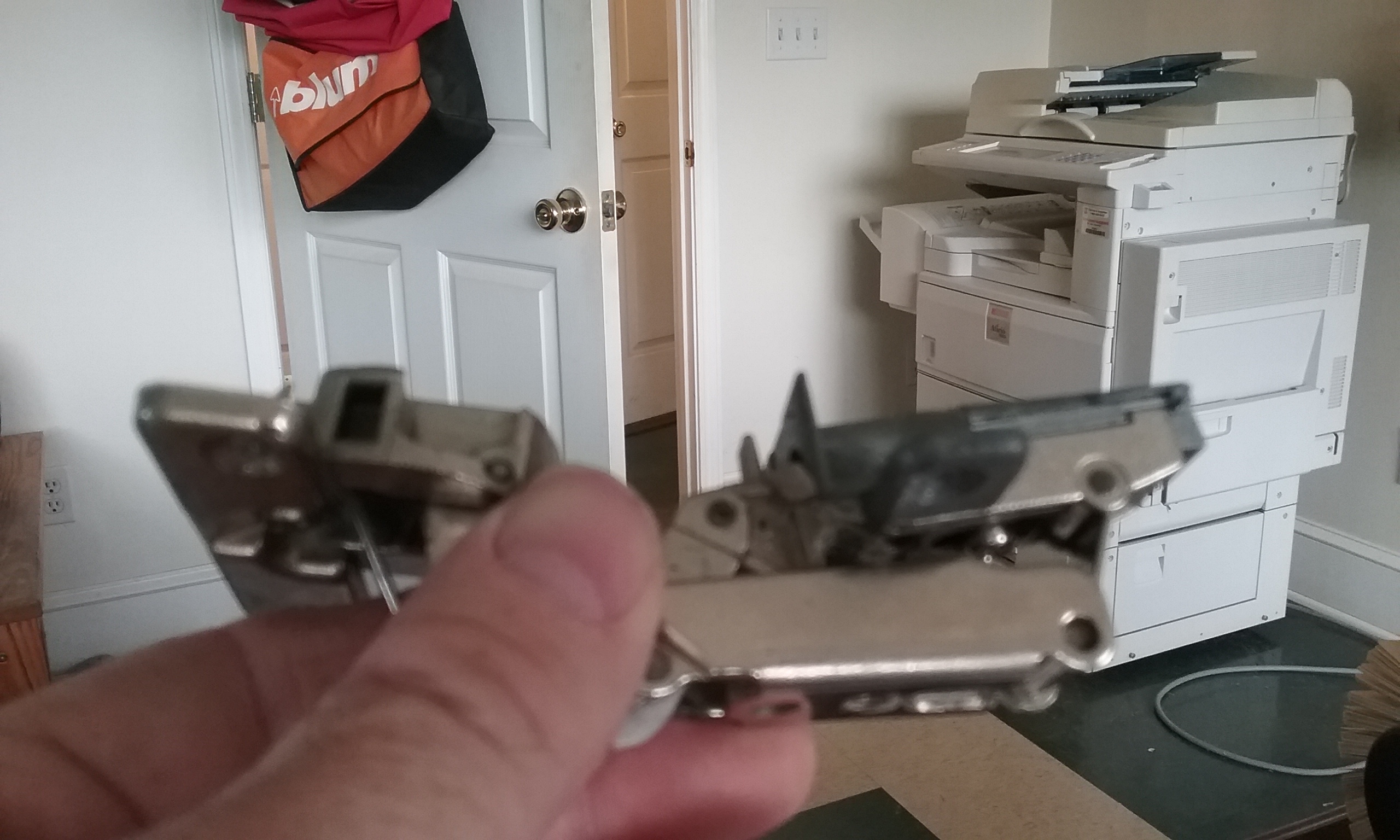

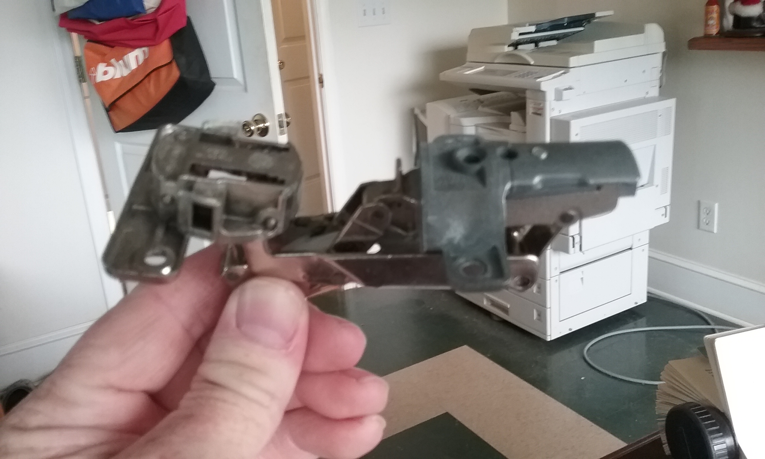

I've got a customer who is wanting me to replace all of the European concealed hinges in her kitchen. The kitchen cabinets were built about 30 years ago. She has a lazy susan in her corner base cabinet. The hinges that were used are a style that I have never seen. The face frame on the cabinet is notched in a half moon shape to accomodate the mounting plate on the hinge. The mounting plate is curved. It's not like the standard flat plates that are used today. The Blum distributor in my area thinks it may be a Grass brand hinge. Does anybody know if this particular style of hinge is still available? And, if so, where could I get a couple of them? Im attaching a few pictures of the hinge and mounting plate. Thanks for your help.

Salice has a plate like that

Yes, the Salice 165 degee 1-1/4" overlay faceframe pie corner hinges require a 35 mm cutout in the faceframe. You have to buy or make a drilling jig to bore the cutout.
