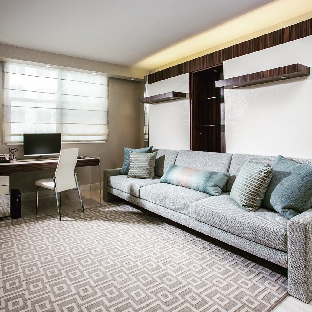

View higher quality, full size image (800 X 755)
View higher quality, full size image (800 X 660)

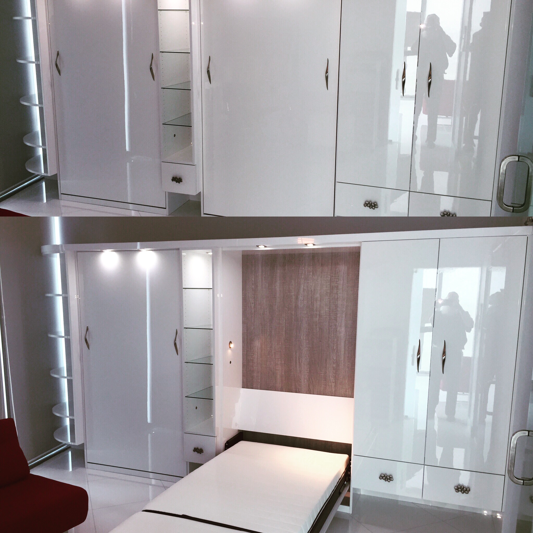

View higher quality, full size image (2048 X 2048)
View higher quality, full size image (1031 X 1031)
